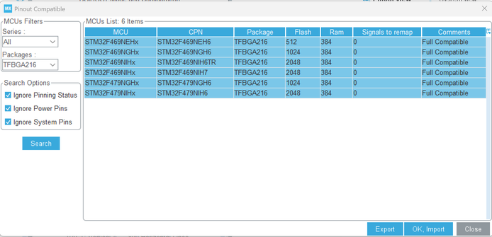

I started my project as a STM32DISCO board project, but I am now moving over to a custom PCB and there will be advantages to using F769 in my application.
This is the list of pinout compatible devices that I am seeing.

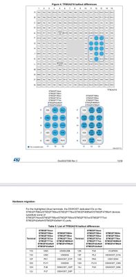

Hi STOne-32, thanks for your reply and pointing me toward AN4660, thank you. AN4660 does indeed shows that STM32F469Nx6 and STM32F769Nx6 are pin compatible, however STM32CUBEMX 'pin compatibility tool' doesn't.

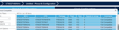

STM32F769NIH is listed as pinout compatible to STM32F469NIH for me:
If you're having trouble, include your IOC file.

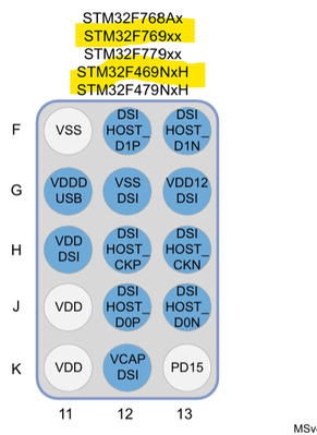

PS: The note I’ve stated previously is not really clear since the STM32F767 TFBGA216 is not compatible pin to pin with the STM32F469 TFBGA216. So, I think the note should be clearer. It can even point to the application note AN4660 for details.
Also, the pin F11 on the TFBGA216 figure (figure 4 of the AN4660) should be VDD and not VSS according to the products datasheets. That should be rectified on the next doc revision.
