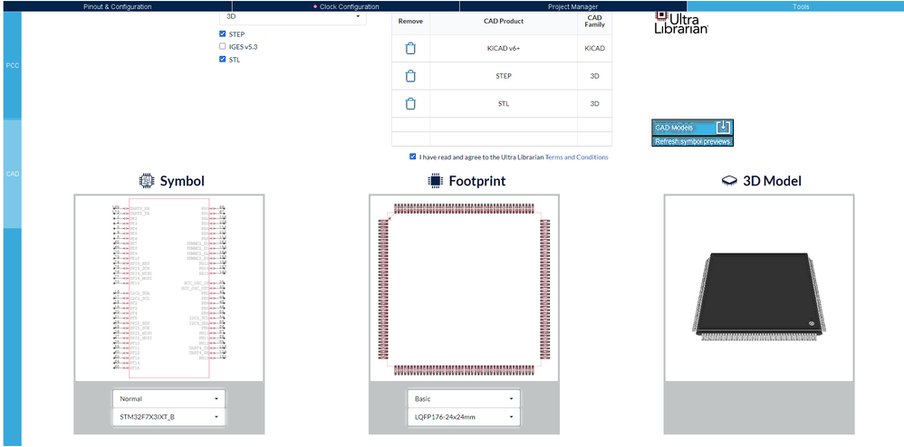

I tried exporting the symbol for STM32F733IET6 along with the pin naming through stm32cubemx(V6.10.0) but all i get is empty boxes
I am using kicad v7. It's not a kicad problem because i've imported symbols recently with no issues. Am i doing something wrong?

The reason that I am exporting from Cube is that I want a symbol where the pin names reflect the functions that I selected in Cube, as well as the custom pin names that I entered in Cube. I don't think this is possible using Ultralibrarian.
