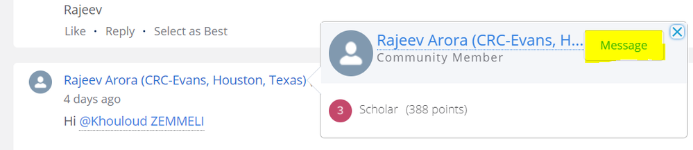

2021-08-09 3:11 AM
Hello @Rajeev Arora
Just put the cursor on my name, then you will find a Message button, as mentioned in the image below, simple click on it, you can send me your project there.
If you still face a problem, don't hesitate to tell me :)
Khouloud
