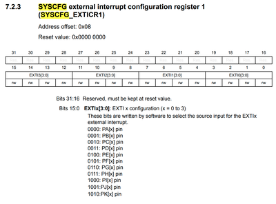

No, it's a hardware limitation. No coding can get around that. CubeMX is simply enforcing the limitations of the hardware.
Look at the SYSCFG->EXTICR1 register for the underlying limitation. For pin 2, EXTI2 can only be set to one port at a time.
2023-08-31 7:37 PM
Just for clarity, there is no problem setting PA0, PB1, PC2 all as EXTI at the same time. The limitation is that for a given number, only one pin with that number can be an EXTI.
If you have multiple EXTI you want to trigger, put them on different numbered pins.
