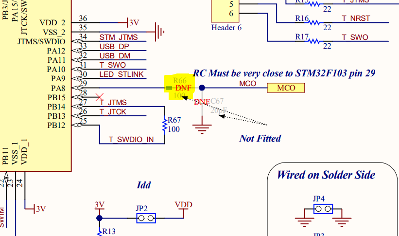

It looks like default settings use MCO bypass. Ensure solder bridges and resistors are configured accordingly.
Looks like R66 is not fitted:
As the pictures show the 8MHz X2 populated, and schematics shows R25 populated, this is clearly CubeMX bug.

Thank you both, yep my guess is that this is because the Nucleo boards I have used source the clock from ST-Link MCO (no crystal fitted) by default and the same invalid default has been generated here. I've checked my various Discovery boards and all have crystals fitted.
I'll just change the default and get on.
