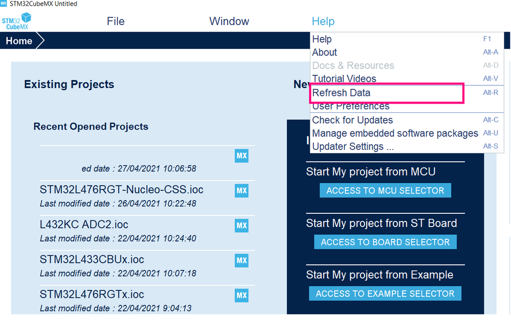

To have the last update of the list, please do a Refresh Data :
