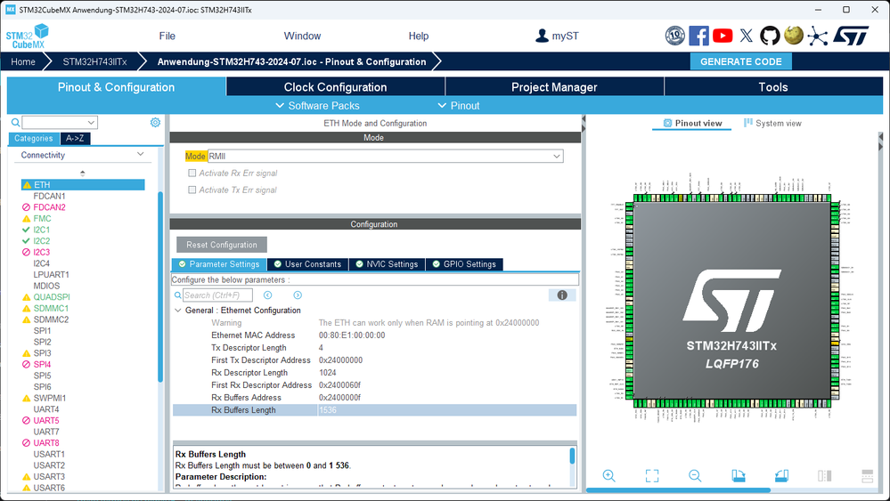

my problem, that uIP-Stack has TCP-Retransmissions with HTTP-trafic. That was observed with Wireshark. The same uIP-Stack works at STM32F7 properly. I'm not sure about Settings in CubeMX with Descriptor Address and Size. My settings are like follows:

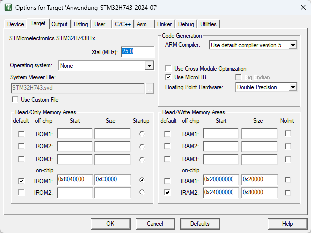

with this setting I have followed Error inside uVision5 (compiler version 5):
Could someone explain how to set Descriptors inside CubeMX properly and get Ethernet work reliable for HTTP trafic?

Why these weird addresses? where have you took this from ?

hello @Pavel A. , it was simply guessed based on size of structs ETH_TxDescListTypeDef and ETH_RxDescListTypeDef found in project. Currently I have changed it to attached screenshot setting and error is gone but the link stability is not the best (same like before). Now I change "RX Descriptor Length" and observe the Improvement but there is non improvements.
