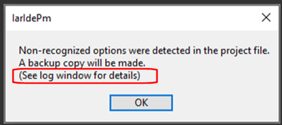

Step 4:a .eww file is generated and I opened the file using IAR software the code builds completly without erros but, I am getting the following notification during opening of file

@curiocity wrote:Step 4: a .eww file is generated and I opened the file using IAR software the code builds completely without errors but, I am getting the following notification during opening of file
What do you mean by, "opening the file" here ?

2.Opening the file means that the generated .eww file is launched using IAR Embedded Workbench.

Did you check what option IAR complains about ?
I suspect you are using an older version that Cube expects.
Try enabling all possible console output options in the WB, you should see an error message.

@curiocity wrote:The problem itself is I am not able to do debugging because device is not detected .
if it's already told you on opening the Project that the Project is bad, then it's not a surprise that things don't work properly with that Project!
Are you sure that your version of IAR actually supports this chip?
You'd need to check that with IAR.

ans:Yes, but is this issue actually related to IAR or CubeMX?
Not able to understand from this log

If your IAR doesn't recognise the chip, then it's not going to work!
"Non-recognized options" sounds exactly like what'd happen with a chip that's not recognised!
@curiocity wrote:Not able to understand from this log
It's IAR's log - so you'd have to ask them about it.
