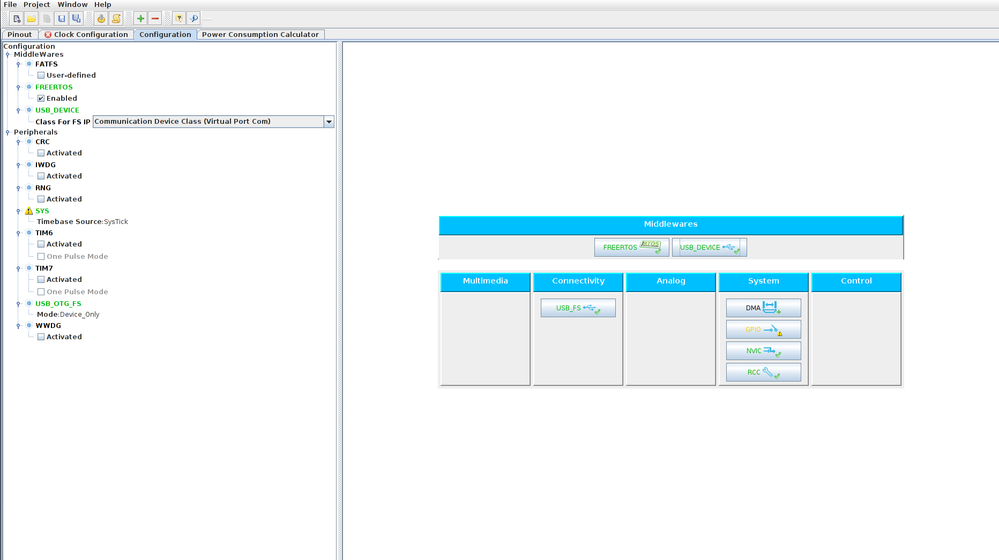

Steps to reproduce:
Create project in CubeMX for STM32F4DISCOVERY, enable USB_FS Device only. Configure clock: PLL_N = 72, PLL_Q=3, that gives me 48 MHz for usb, other settings remain unchanged. In configuration I enable CDC device with default parameters. Generate code for SW.
I add some led toggle in order to know it it is running.

and here settings from CubeMX:
