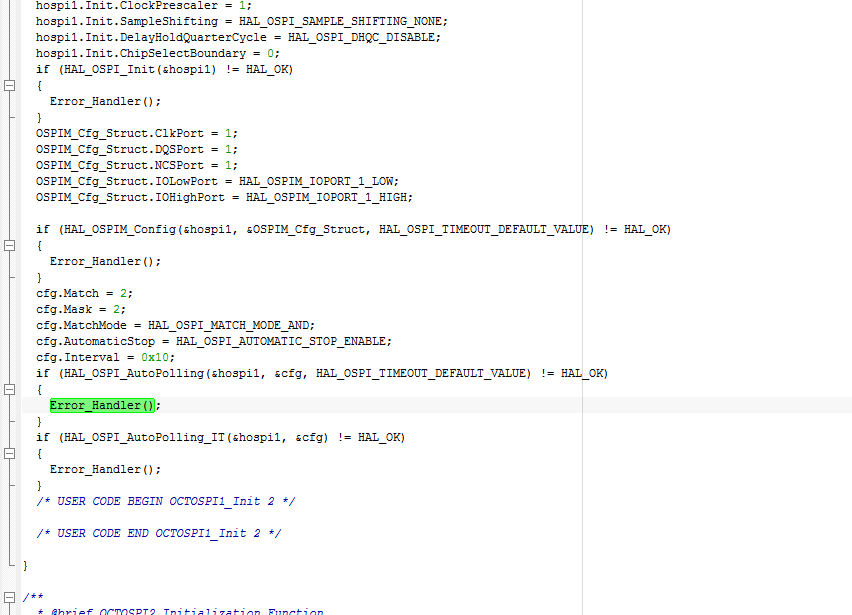

The generated code failde in OCTOSPI1_Init/ HAL_OSPI_AutoPolling:
it runs by
if ((hospi->State == HAL_OSPI_STATE_CMD_CFG) && (cfg->AutomaticStop == HAL_OSPI_AUTOMATIC_STOP_ENABLE))
else
into HAL_Error.
does any one know why?
CubeMX: V5.1.0
Package for STM32L4: V1.13.0
Octospi2 on Hyperram works fine.

2019-04-24 7:19 AM
Using L4R9I-EVAL Board. cubemx generate the ini cod for OCTOSPI1:
static void MX_OCTOSPI1_Init(void)
/* USER CODE BEGIN OCTOSPI1_Init 0 */
/* USER CODE END OCTOSPI1_Init 0 */
OSPIM_CfgTypeDef OSPIM_Cfg_Struct = {0};
OSPI_AutoPollingTypeDef cfg = {0};
/* USER CODE BEGIN OCTOSPI1_Init 1 */
/* USER CODE END OCTOSPI1_Init 1 */
/* OCTOSPI1 parameter configuration*/
hospi1.Instance = OCTOSPI1;
hospi1.Init.FifoThreshold = 4;
hospi1.Init.DualQuad = HAL_OSPI_DUALQUAD_DISABLE;
hospi1.Init.MemoryType = HAL_OSPI_MEMTYPE_MACRONIX;
hospi1.Init.DeviceSize = 25;
hospi1.Init.ChipSelectHighTime = 4;
hospi1.Init.FreeRunningClock = HAL_OSPI_FREERUNCLK_DISABLE;
hospi1.Init.ClockMode = HAL_OSPI_CLOCK_MODE_0;
hospi1.Init.WrapSize = HAL_OSPI_WRAP_NOT_SUPPORTED;
hospi1.Init.ClockPrescaler = 1;
hospi1.Init.SampleShifting = HAL_OSPI_SAMPLE_SHIFTING_NONE;
hospi1.Init.DelayHoldQuarterCycle = HAL_OSPI_DHQC_DISABLE;
hospi1.Init.ChipSelectBoundary = 0;
if (HAL_OSPI_Init(&hospi1) != HAL_OK)
Error_Handler();
OSPIM_Cfg_Struct.ClkPort = 1;
OSPIM_Cfg_Struct.DQSPort = 1;
OSPIM_Cfg_Struct.NCSPort = 1;
OSPIM_Cfg_Struct.IOLowPort = HAL_OSPIM_IOPORT_1_LOW;
OSPIM_Cfg_Struct.IOHighPort = HAL_OSPIM_IOPORT_1_HIGH;
if (HAL_OSPIM_Config(&hospi1, &OSPIM_Cfg_Struct, HAL_OSPI_TIMEOUT_DEFAULT_VALUE) != HAL_OK)
Error_Handler();
cfg.Match = 2;
cfg.Mask = 2;
cfg.MatchMode = HAL_OSPI_MATCH_MODE_AND;
cfg.AutomaticStop = HAL_OSPI_AUTOMATIC_STOP_ENABLE;
cfg.Interval = 0x10;
if (HAL_OSPI_AutoPolling(&hospi1, &cfg, HAL_OSPI_TIMEOUT_DEFAULT_VALUE) != HAL_OK)
Error_Handler();
if (HAL_OSPI_AutoPolling_IT(&hospi1, &cfg) != HAL_OK)
Error_Handler();
/* USER CODE BEGIN OCTOSPI1_Init 2 */
/* USER CODE END OCTOSPI1_Init 2 */
The call to HAL_OSPI_AutoPolling (line 87) runs into error.

after donwload the cubemx 5.2 and package L4.1.14, the error remains. could you send me your generated code? I need only the project source code.

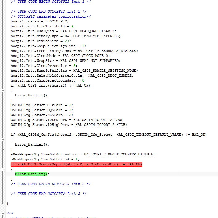

I test it now with a blank new STM32L4R9I-EVAL Board and without any modification of the code generated from cubemx. Since the standard Error-Handler() is an empty function, one have step into it, otherwise it runs through without any warnings!
With original code it runs into error even in MX_OCTOSPI2_Init / HAL_OSPI_MemoryMapped, but this is a known bug. HAL_OSPI_MemoryMapped() will be called after hyperbus is configured (call HAL_OSPI_HyperbusCfg) and the memory-mapped mode i configured (call HAL_OSPI_HyperbusCmd
with
sCommand.AddressSpace = HAL_OSPI_MEMORY_ADDRESS_SPACE;
sCommand.AddressSize = HAL_OSPI_ADDRESS_32_BITS;
sCommand.DQSMode = HAL_OSPI_DQS_ENABLE;
sCommand.Address = 0;
sCommand.NbData = 1;)
I wonder why it is still not changed in the new Package L4.1.14
