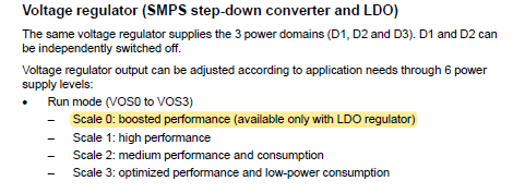

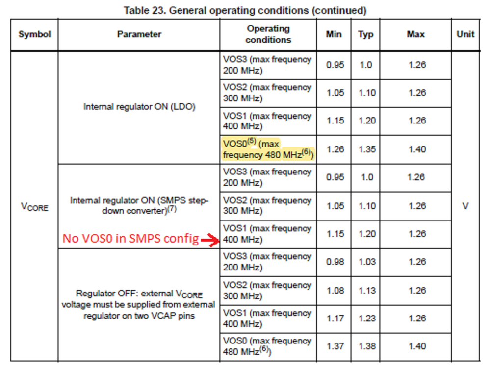

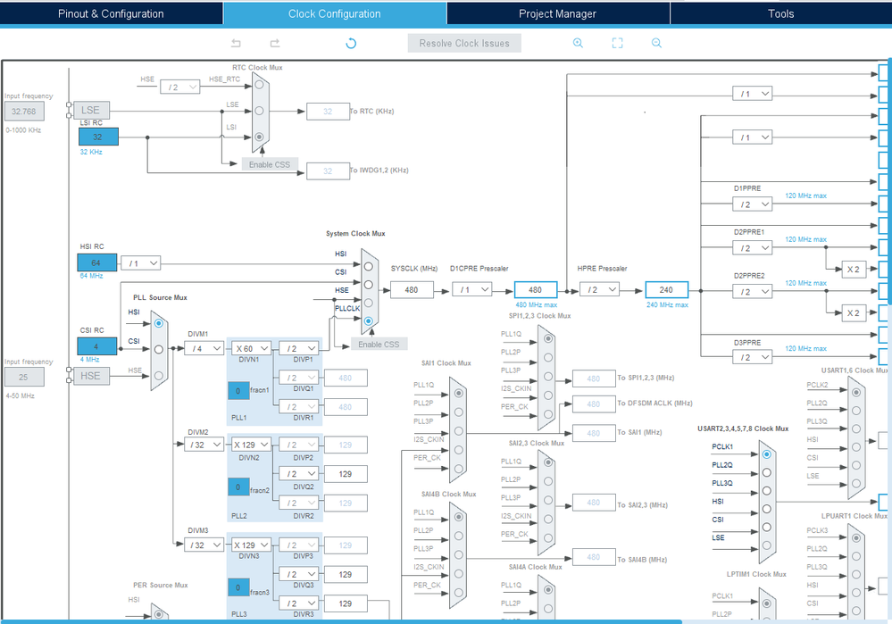

First, the generated code doesn't correspond to the CubeMx config (as shown in your screenshot).
Second, the NUCLEO-H745ZI-Q board supports only SMPS config power supply. To run @480MHz you should select VOS0 (voltage scale 0) as indicated in the datasheet:
But VOS0 is only supported with LDO config not SMPS like indicated in the datasheet:
So you can't run your MCU with this board @480MHz.

Oops you are right the code I shared is wrong, I've updated the correct code generated by CubeMx
I followed some ST examples and set the max to 480 Mhz, now I don't really want to go to max frequency.

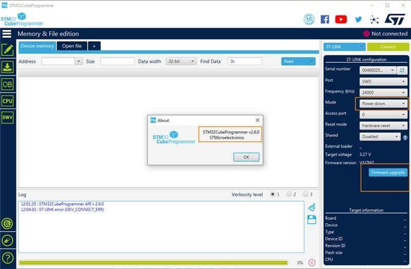

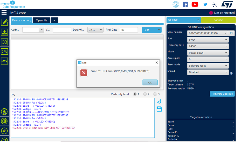

2021-07-07 2:54 AM
Thanks for the quick reply, I've tried the suggestion but getting a different error now. I'm using the latest CubeProgrammer 2.7.0.
2021-07-07 2:56 AM
What is the issue? and what kind of error you are facing? Could you share a screenshot?
2021-07-07 3:09 AM
Could you please try to upgrade your STlink firmware:
Connect your board and click on "Firmware upgrade" button ..
2021-07-07 3:24 AM
Awesome, firmware upgrading the ST_LINK to V3J7M3 worked, now I'm able to connect and erase the flash. Thank you very much.
