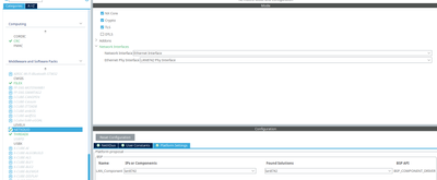

I'm using CubeMX 6.1.0 and CubeIDE 1.13.2 but the version of IDE should not matter as bug is already in the cubemx-generated code. Below you see the cubemx configuration part of NETXDUO:
In ProjectManager I selected:
It seems that this one is only appearing in Makefile-Mode. Nevertheless this is needed for our project.

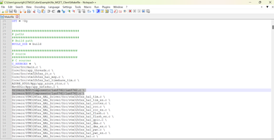

When I now "generate code" the produced Makefile has twice the source file of the network driver:
/home/pascal/STM32Cube/Repository/STM32Cube_FW_H5_V1.1.1/Drivers/BSP/Components/lan8742/lan8742.c \
which leads to:

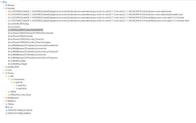

This error/problem has returned on Ethernet examples in CubeMX for the STM32H573I-DK. However the makefile looks far different and does NOT have two lines relating to LAN8742. The error message is: ...STM32Cube/Example/Nx_MQTT_Client/Drivers/BSP/Components/lan8742/lan8742.c:61: multiple definition of `LAN8742_RegisterBusIO'; ./Drivers/BSP/Components/lan8742.o:C:/Users/dbaker/STM32Cube/Example/Nx_MQTT_Client/Drivers/BSP/Components/lan8742/lan8742.c:61: first defined here
I am using STM32CubeIDE 2.0.0 and STM32CubeMX 6.16.0
Suspect .ioc, and makefile (renamed to makefile.txt) attached.

2025-11-27 12:48 AM
Hello @LostIon
Thank you for bringing this issue to our attention.
After checking the generated Makefile file , the line Drivers/BSP/Components/lan8742/lan8742.c \ is added twice to the project (NX_MQTT_Client example for STM32H573I-DK)
So a ticket 222632 has been escalated to dev team to address this behavior.
