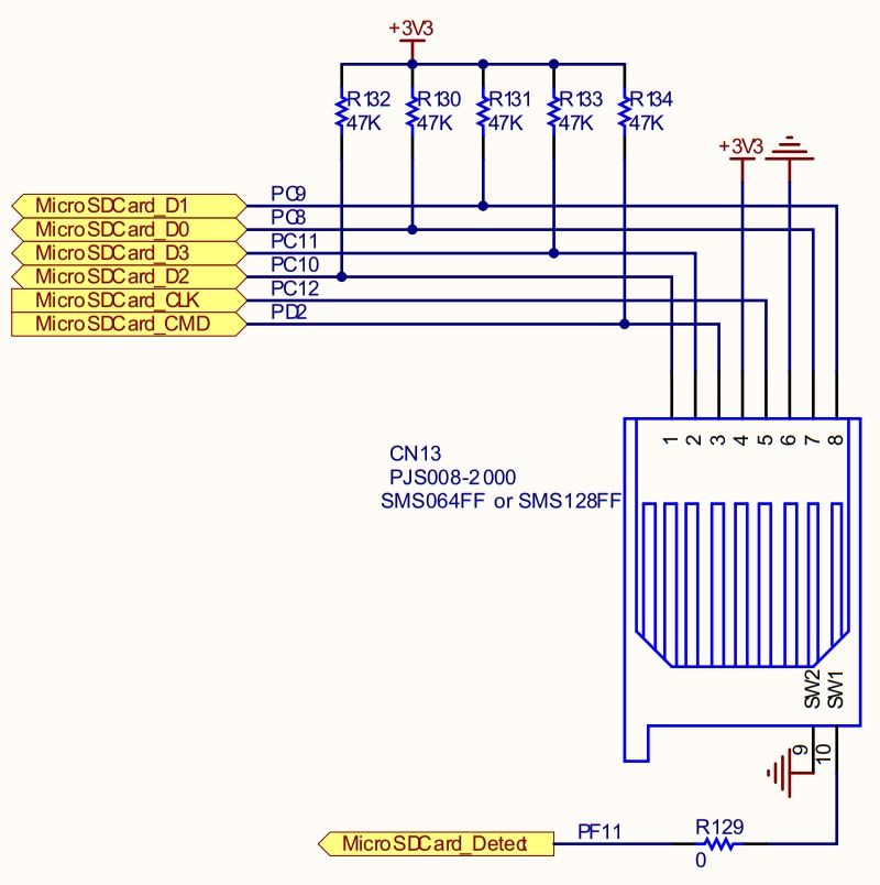

Recommend circuit implementation, very short, equal length, ideally no more than a few inches. Pull-ups at the socket's edge. The card detect GPIO can be picked from available pins.

Pay very close attention to Clive's response. I spent hours and hours single stepping code trying to find the problem on an H7A3 and it was H/W. 10K resistors as commonly fitted to SDcard modules are too low. Note also that there is no pullup on the clock signal.

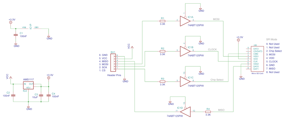

The CATALEX SD card adapter is designed for SPI communication. I have included the schematic for your convenience.
First, I disconnected the outputs of the 74ABT125PW buffer from the pins of the SD card socket (CSCONN part number: CTF110919138002) represented on the right side of the schematic. Then, by exposing the soldermask, I soldered jumper wires to be able to tap the connector pins individually.

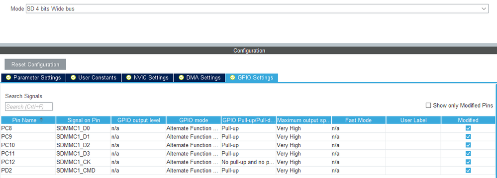

Instead of using pull up resistors (I don't have any at the moment), I enabled GPIO Pull-up resistors on all pins except the Clock pin. Regarding the value of the resistors, the internal pull up resistors of STM32L4 are about 40 kOhm. To check if the pull-up resistors were working, I inserted an infinite while loop after the initialization functions and checked the voltage of the required pins. They all showed 3.3V and with that, sorted out the hardware.

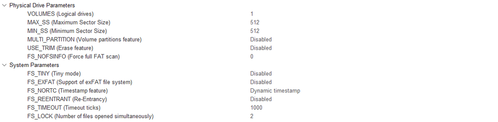

As for the setup and program, I have included pictures of the configurations. I only had to include the GPIO pull up resistors. I tested the program for both 4bit SDIO and 1bit SDIO. Both seemed to be showing the same error.
SDMMC GPIO configuration:

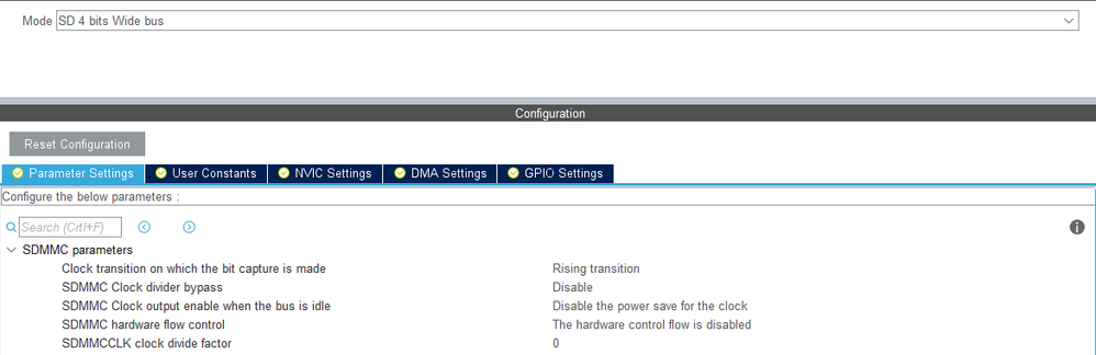

SDMMC Parameters:
FATFS Set Defines:

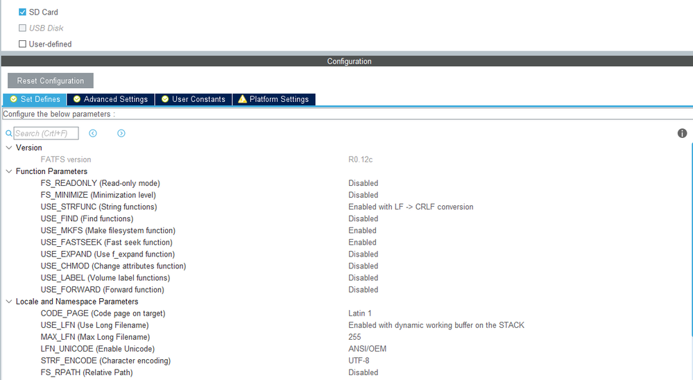

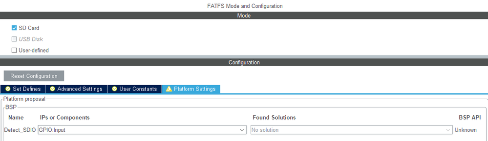

FATFS Platform Settings:

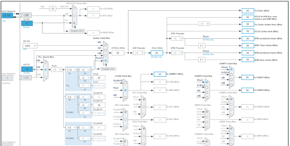

Clock Settings:

Have you set up a card detect pin? I think the generated code needs this and I've just noted the error you get in your first post
"These IPs still have some not configured or wrong parameter values: [FATFS, Verify the Platform Settings Tab]"
This shouldn't happen and is probably related to the card detect issue. Set any pin as an input in CubeMX and then in the FATFS platform setting allocate this pin as the card detect.
If you can wire this do it. Otherwise chase references to that pin in the generated code and patch the code so that it always returns card-detected. I think the generated code has some "user code" blocks so you can do this in a way that CubeMX doesn't overwrite

So I tried a couple of things. I initialized a random GPIO pin as Input and selected it as the Detect_SDIO. I wasn't familiar with the mechanism of that pin - if it had to be pulled low or high to show that a card had been connected. On further investigation, I found that the 9th pin on the microSD card connector is a mechanical switch that would be shorted to VSS (GND) when a card was inserted. So, I figured the Detect_SDIO pin should be pulled low. Since that pin was associated with the BSP_SD_Init() function, I used the debugger to step over lines of code until I got to the BSP_SD_Init function to check the return value of res. Finally, got it working (FR_OK at BSP_SD_Init) but on reaching f_mount(), it would return a FR_DISK_ERR. All this was in 4 bit wide bus.
