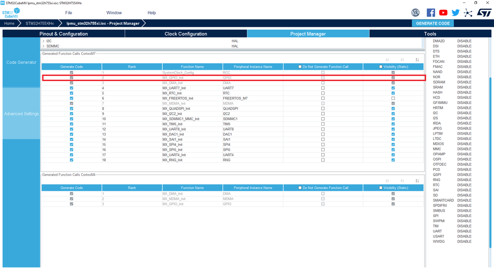

Hello @Lzhou.1 ,
Thanks for your feedback,
It seems that you checked the " Do not Generate Function Call " in your CubeMX configuration.
Could you please uncheck it and check the visibility field instead, just like the attachment below.
I hope this helps :) !

2022-02-08 8:37 PM
Yes, it works, thank you very much!
