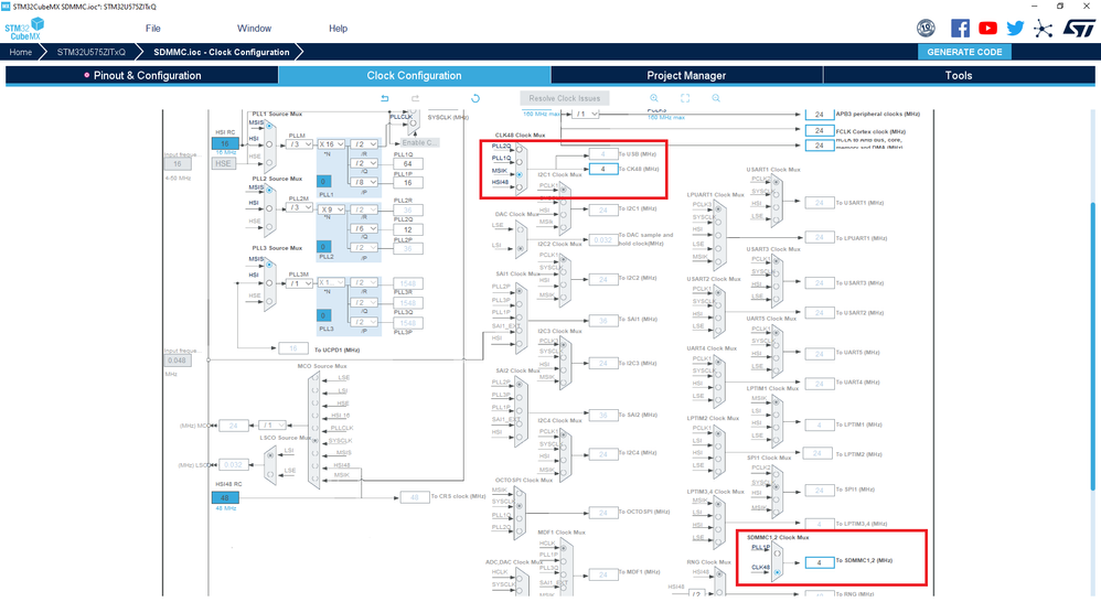

I am aware of the clock limitations of the SDMMC vs AHB bus and have adjusted PLL1P (sources SDMMC clock) to 16 MHz.
If I manually change the code to set it to SCALE 4 every thing seems to work ok but I would rather not deviate from the auto generated Cube MX code. Is it possible to achieve voltage scale 4 with SDMMC?

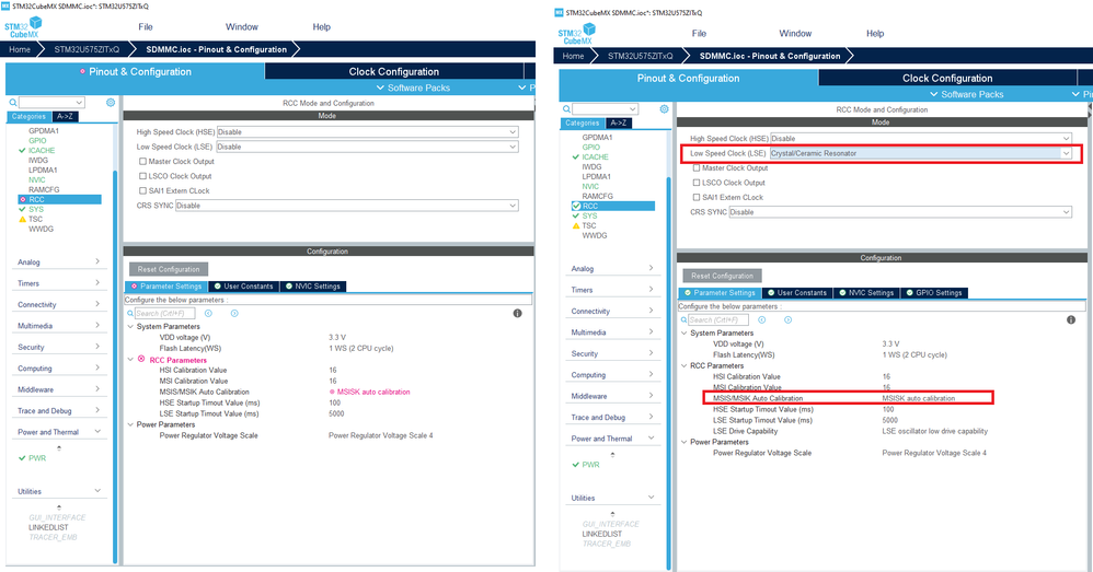

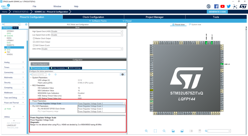

Hello @BSmit.7 ,
Actually this is a normal behavior, Range 4 is not allowed when using PLLs, HSI48 not divided by 2 or MSKI/MSIS having 48 MHz.
SDMMC uses either PLL1P or CLK48 as a source clock. In this case, Range 4 can be selected, when SDMMC uses CLK48 and CLK48 Clock Mux is set to MSIK.
PS: Adjust the frequencies according to your application and please make sure to enable LSE as it is required by the MSIK to calibrate itself.
I Hope this helps :)

2022-02-09 1:10 AM
Hi Sara,
Thanks for looking into this; Cube MX version 6.4.0.
The attached ioc file has:
Generating the code as-is for the ioc file will put the processor into LL_PWR_REGU_VOLTAGE_SCALE4 - line 124 of main.c for me.
If you enable the SDMMC1 in 4 bit mode this changes to LL_PWR_REGU_VOLTAGE_SCALE3
Many thanks
Ben
2022-02-09 4:49 AM
Hello @BSmit.7 ,
