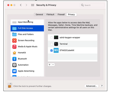

According to UM1718, macOS requires Full Disk Access to allow STM32CubeMX to load project files or install other packages from the file system. To grant Full Disk Access to STM32CubeMX, follow these steps:
1. Open System Preferences and navigate to Security & Privacy.
2. Select the Privacy tab.
3. In the left panel, choose Full Disk Access.
4. Click the lock to make changes, then add STM32CubeMX to the list and enable its checkbox.
Additionally, since CubeMX is a Java application, the Java runtime itself may also require Full Disk Access. In the same Full Disk Access section, consider adding both:
- The STM32CubeMX application
- The Java binary (typically located at `/Library/Internet Plug-Ins/JavaAppletPlugin.plugin/Contents/Home/bin/java` or `/usr/bin/java`)
After making these changes, restart STM32CubeMX to ensure the new permissions take effect.
