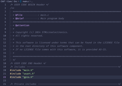

  9. Open CM7/Src/main.c and includes at the top of the file should look like this:haxellio_0-1732497896678.png
Why this happens? I don't know, but I have some clues.
If we click on the CMake icon on the side panel, it'll open current CMake configuration. Notice that under Project Outline, there are our two sub-projects for both cores, but there's no source code files attached to them.
If we create project for any of the single-core devices using the same method as above (see reproduction steps), we will get this project outline:
All source files now have working IntelliSense and all includes do resolve without errors.

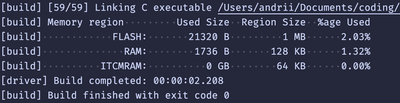

Now the root project and sub-projects successfully builds.
