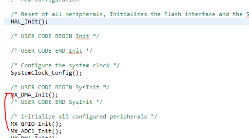

Is DMA initialiced before the ADC? it should be
It is a known CUBEMX issue.
Also check the buffer sizes you configured, they might not match with your real buffer.
