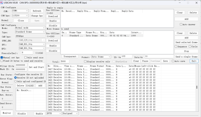

I have an USB to CAN analyser, I am sending a CAN message under while loop which I am able to see on my PC.
From the same analyser I am sending a CAN frame whose ID is being checked under callback function.

This messages are transferred from MCU.I am able to see them on PC.
