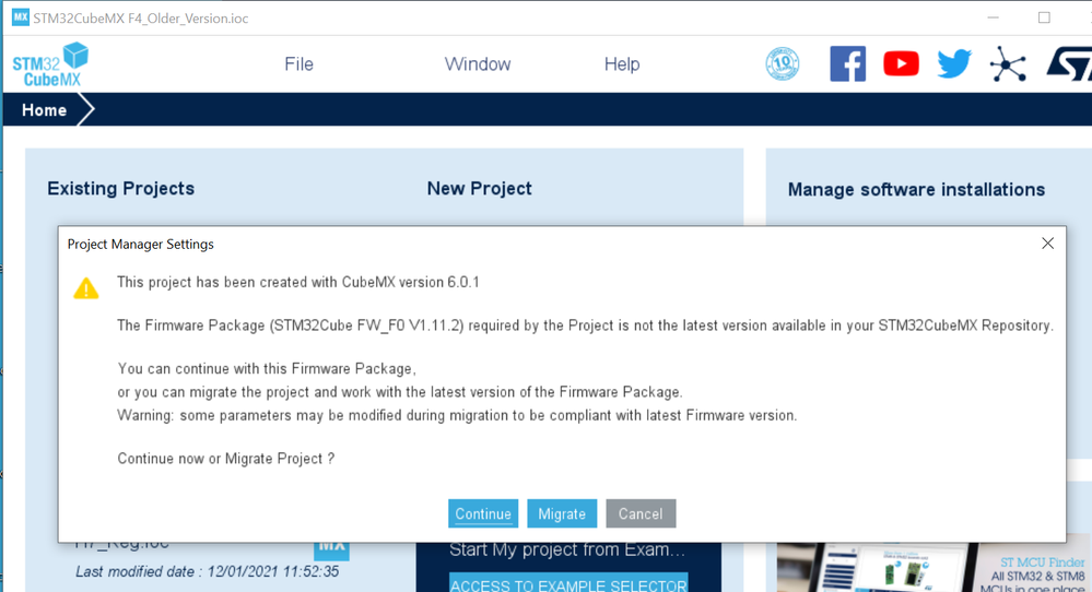

The migration dialog text may be a little bit confusing, so let me first explain the message behind this warning pop up. In fact STM32CubeMX (same for STM32CubeIDE) detects if the project was created with an older version of the tool and if this is the case, it proposes the user to either migrate to use the latest STM32CubeMX database and STM32Cube firmware version, or to continue.
Basically the message says ;The project was created with a MCU database and FW package that is not present in your repository. It exists actually a newer MCU database and Cube software than the one you used.
You may select continue to use original firmware used at project creation and in this case it will downloaded into your repository as well as the MCU and IPs database (stm32cube_db), or you may select migrate, and in this case your project will be modified to fit the current database definition.

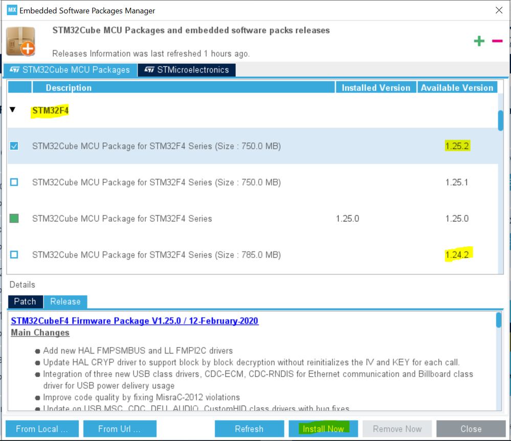

Concerning STM32Cube FW_F4 V1.24.2, it is an old version of F4 Cube Firmware, the latest version is STM32Cube FW_F4 V1.25.2.
The installation can be performed using STM32CubeMX, all the packages available for download are displayed along with their version including the version currently installed on the user PC (if any).
To download new STM32 MCU packages, select Help > Manage embedded software packages to open the Embedded Software Packages Manager (see attached screenshot below).
You can choose “From Local ...�?, then browse to select the zip file of the desired STM32Cube MCU package that has been previously downloaded. An integrity check is performed on the file to ensure that it is fully supported by STM32CubeMX.
