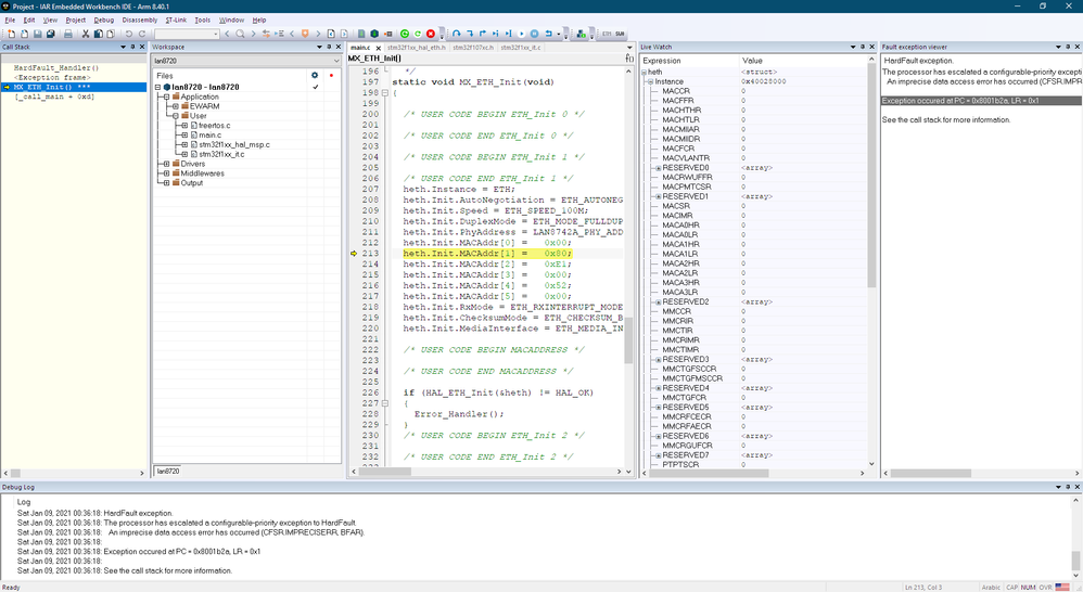

i Use stm32f107RC and lan8720.
when MX_ETH_Init(); function run i got Hard Fault in This line:How can I solve this problem?

2021-01-08 1:44 PM
It's an imprecise error, which means the error is probably not on the line that triggered it. Most likely the issue is elsewhere.
But you should verify that heth.Init.MACAddr points to a valid location in RAM.
2021-01-08 9:02 PM
yes
i checked the address of the variable, it is in RAM (0x200013B0)
I Changed the microcontroller IC, which is the same problem again.

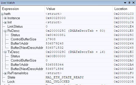

When I want to ping, it receives data but does not send data.
What is the problem?
�?Status 0x00D00000 is Not Defined... in Header
