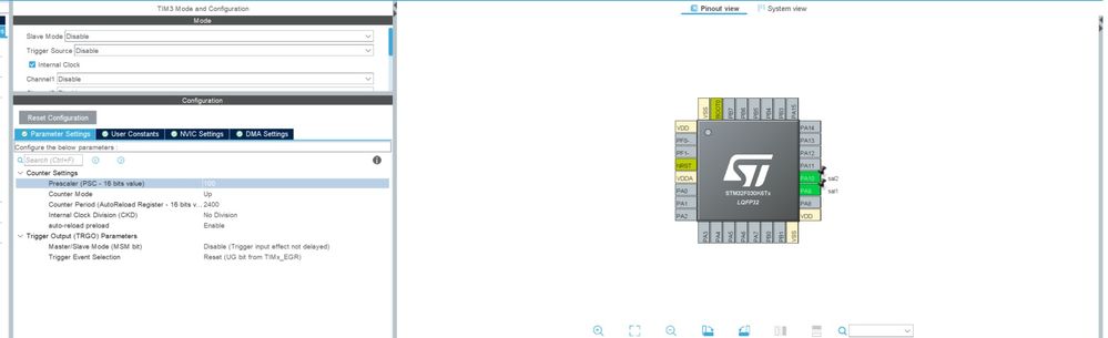

  TIM_InitStruct.Prescaler = 1000;
  TIM_InitStruct.CounterMode = LL_TIM_COUNTERMODE_UP;
  TIM_InitStruct.Autoreload = 2400;

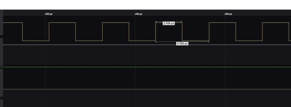

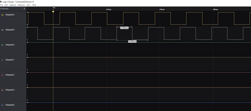

the timer interrup is:
i view with analyzer logic the time, but is not true value, the time is wrong.
the time is 2.9 us ever, i want 5ms the update timer interrup

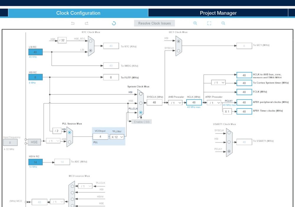

The counters start at 0, so you must subtract a 1.
Therefore, a prescaler of 47 will downscale the timer clock from 48 MHz to 1 MHz. In upcounting mode, the timer will increment once per µs. To get 5ms update intervalls, set TIM3_ARR to 4999. Seems like you generate an interrupt and toggle the output from the interrupt handler? This could also be done by using output compare/PWM modes with dedicated timer channels without depending on any software (IRQ). Keep also in mind, that the clock tree may generate lower clocks for APB busses/timers, check clock configuration.
hth
KnarfB
Piranha
Chief II
Also the prescaler and autoreload values in code doesn't correspond to the ones described in the topic.
yes, this is diferent, but with prerscaler 100 and autoreload 2400 the time is wrong. i do diferents test, i don´t know what configuration is wrong, i am doing configuration with projet manager.

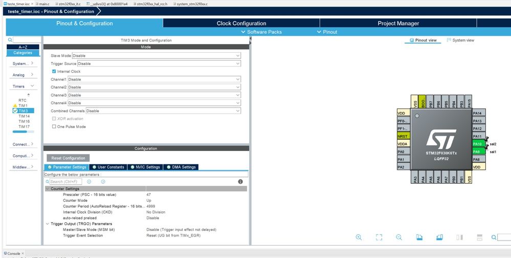

configure the prescaler of 47 and tim3_ARR to 4999 and continue the value equal 2.9 us, i have configuration wrong?
