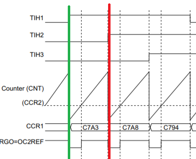

I'm using an STM32F030K6 and I need to measure the time between the rising edge of 2 signals.
The 2 signals (square wave) are not in phase and intended to use TIM1 to:
* rising edge of signal 1, make timer start (internaly clocked);
* rising edge of signal 2, capture the timer and trigger the DMA;
* automatically stop at the timer to wait for the rising edge of signal 1 again.
I find some information in sections 13.3.17 and 13.3.18, but not enough to understand the process and how I can prepare the setup using CubeMX.
Could you please explain the process and recommend some specific reading on this example?
Thank you

2018-12-06 9:56 AM
OK.
That was my first thought of how to resolve the situation.
But I thought if it was possible to get even more out of the hardware and use XOR just like they do with the hall sensor.
Thanks for the answers!
