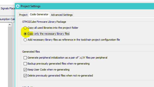

Hello!
For some reason ''stm32l1xx_ll_rcc.c'' is not referenced from your project.
I found that the problem starts when you choose the highlighted options at settings.(first and second)
It is not enough to just change the option in your project.
Make a project without choose this settings and will be ok
regards
vf
2017-09-09 4:25 AM
Thank you very much Vangelis for the detective work and workaround solution! It allows me to go further without waiting for ST update on STM32CubeMX. I will mark your reply as the answer and hope that ST saw this 'bug report'.

After the STM32CubeMX update to 4.1 and L1 driver update to 1.8.0 I noted the following:
- choosing the 'Copy only the necessary library files' radio button, allows a compilation without errors;
- the generated code remains un-functional.
