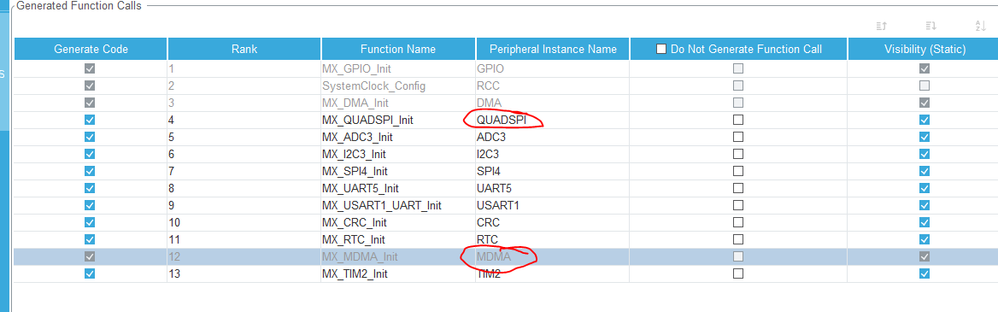

Cube mx is generating this order of init code.
Stm32cube ide 1.9.0
stm32cubeh7 1.10.0

Hello @Community member,
I am getting back to you regarding this issue. It has been fixed within the STM32CubeMX V6.7.0.
Thank you.
Chahinez.
I have reproduced the issue and reported it the STM32CubeMX team for further check.
Internal ticket number: 130352(This is an internal tracking number and is not accessible or usable by customers).
Thank you.
Chahinez.

2022-12-01 2:39 AM
Thank you.
Chahinez.
