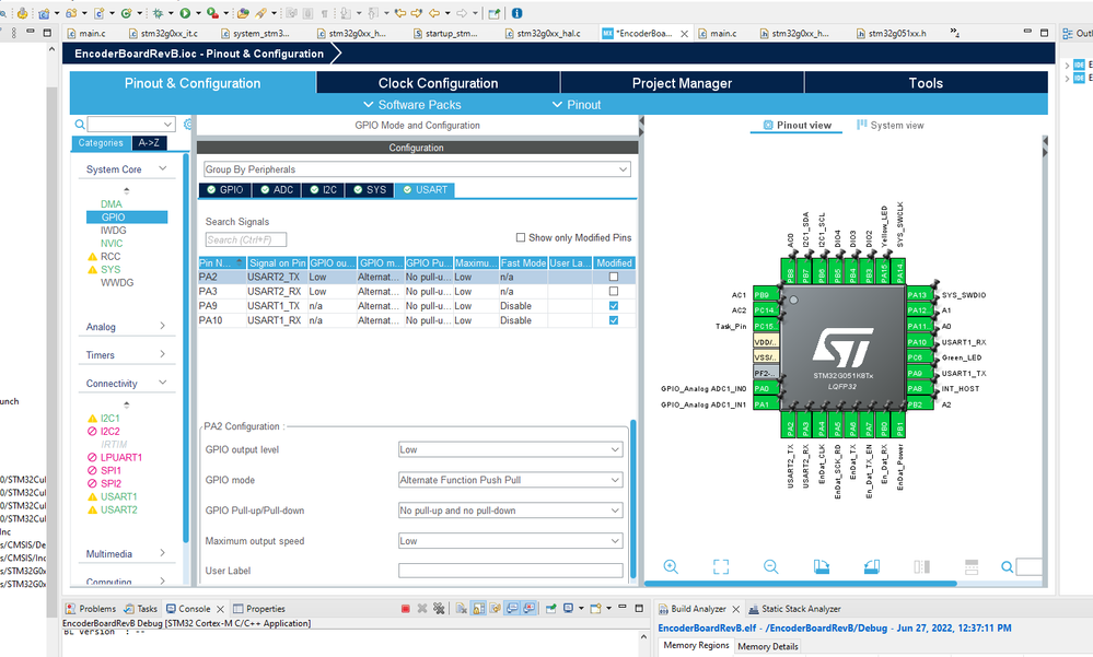

First the GUI is all screwed up.
When I look at USART2 It gives me the choices for
GPIO output level,
GPIO mode,
GPIO Pull-up/Pull-down
Maximum output speed
User Label,
it is missing Fast Mode.

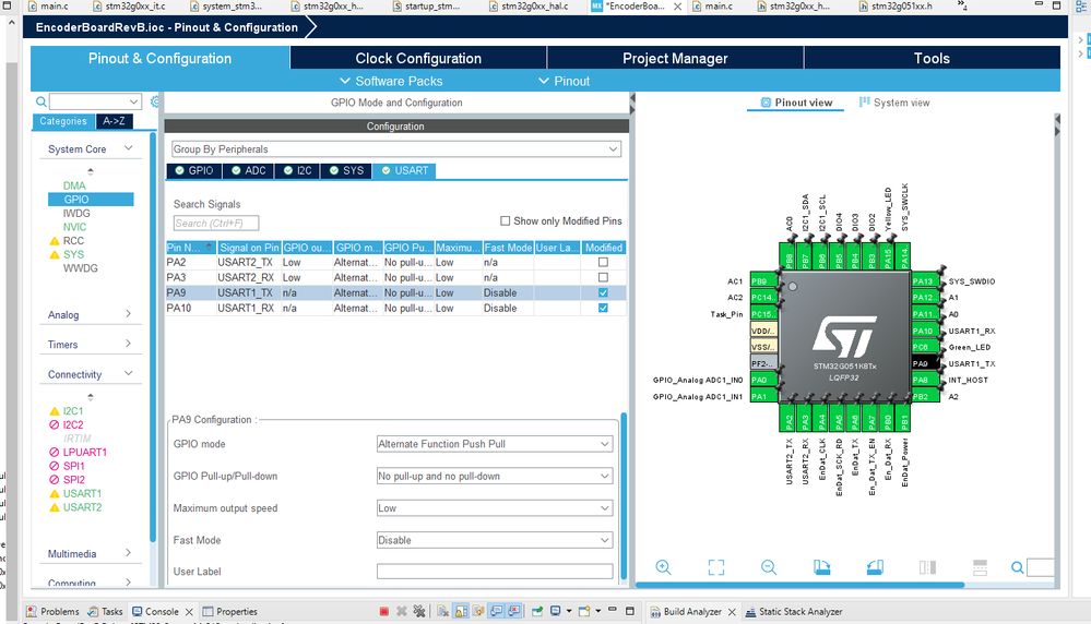

I click down to USART1_TX and the list is different. It has
GPIO mode,
Maximum output speed,
Fast Mode
User Label
This one is missing GPIO Output Level.
And it says it is "Modified" I told it to revert to the default and it is still "Modified"

2022-06-27 2:58 PM
I opened up another bug report for the GPIO Registers.
But I found the issue that I was trying to solve here.
The MX program correctly set USART2_TX to alternate function AF1 but left USART1_TX as alternate function AF0 when it should have been AF1 also. That was why I was trying to look at the GPIO registers. Yet another MX program bug...

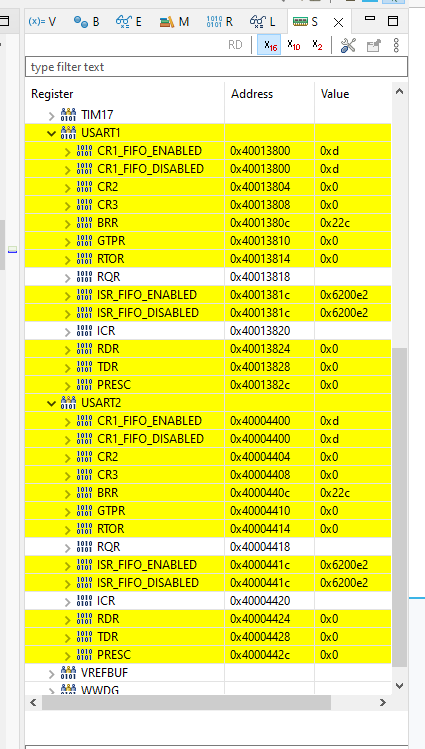

2022-06-27 12:45 PM
Well this is curious. I just looked at the registers for both USART1 and USART2 and they are identical!
So it is not the setup of the USART1 or USART2 that one works and the other does not.
It must be the GPIO for the two TX pins.

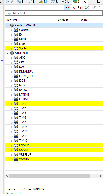

2022-06-27 12:59 PM
Why can't I see the GPIO registers in the debugger?
Am I missing them?
