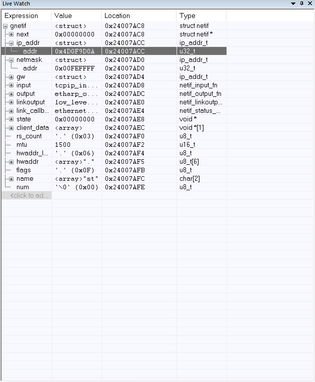

After I generate the code, I add an extern variable to my main.c to be able to track whether the device has obtained an IP address:
/* USER CODE BEGIN PV */
extern struct netif gnetif;
/* USER CODE END PV */Moreover, I add the standard LwIP/RAW IP callbacks t the main loop:
/* Infinite loop */
/* USER CODE BEGIN WHILE */
while (1)
/* USER CODE END WHILE */
/* USER CODE BEGIN 3 */
ethernetif_input(&gnetif);
sys_check_timeouts();
/* USER CODE END 3 */This code works well and I am able to get an IP address (I can determine it frome the gnetif->ip_addr field), I can see all the proper ARP request in WireShark and I am able to ping the device:

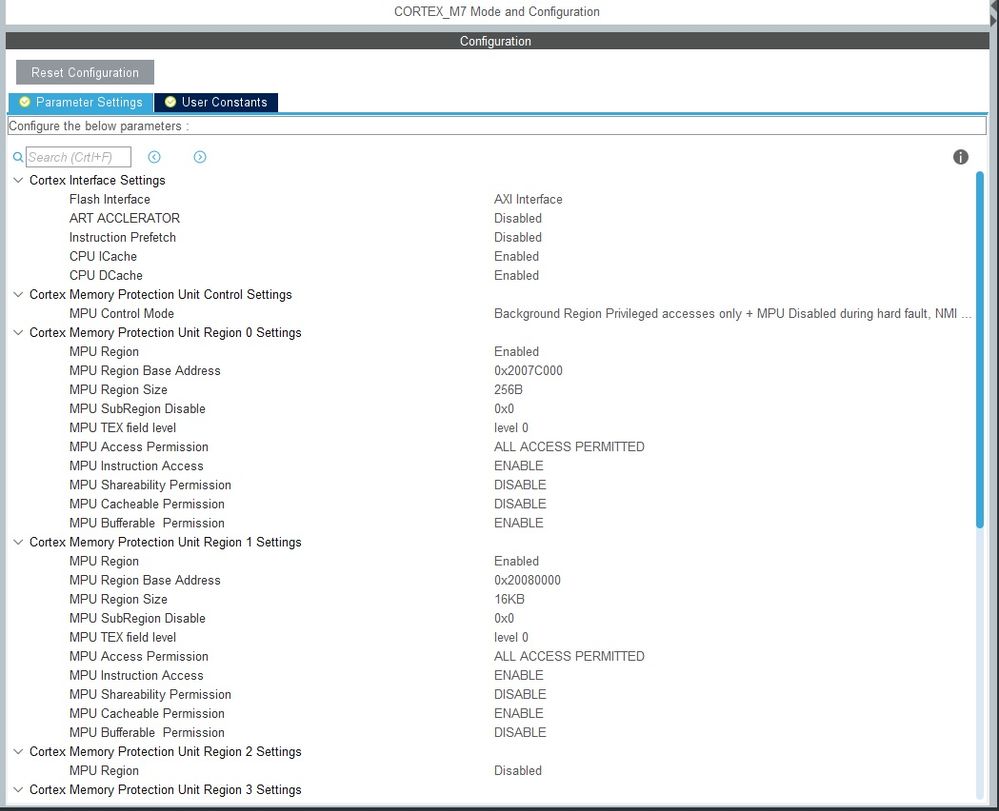

Hi @KR
I apologize for the delay and I have the honor to inform you that I finally had a solution to run the LWIP on H7
1- You must activate the MPU control mode in Background Region Access Not Allowed + MPU Disabled during hard fault, NMI and FAULTMASK handlers
2- You must configure the region 0 and 1 according to the configuration found in the code
You will find a screen print for the simulation and generate code
I will remain at your disposal for any other questions.

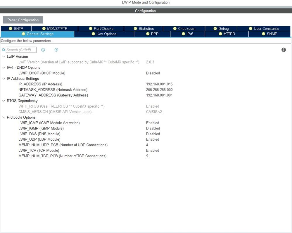

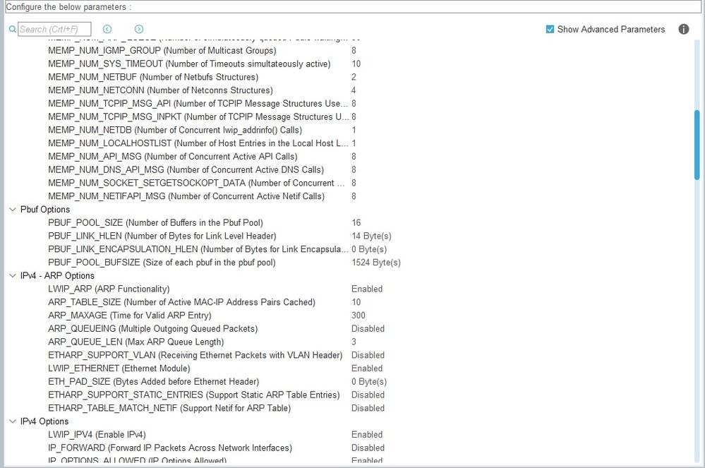

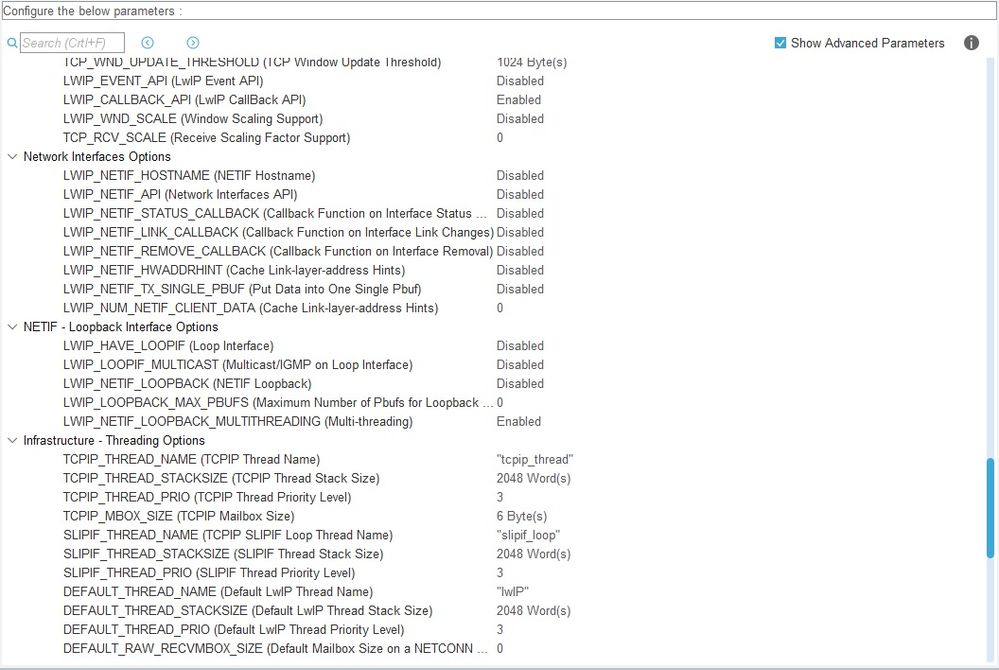

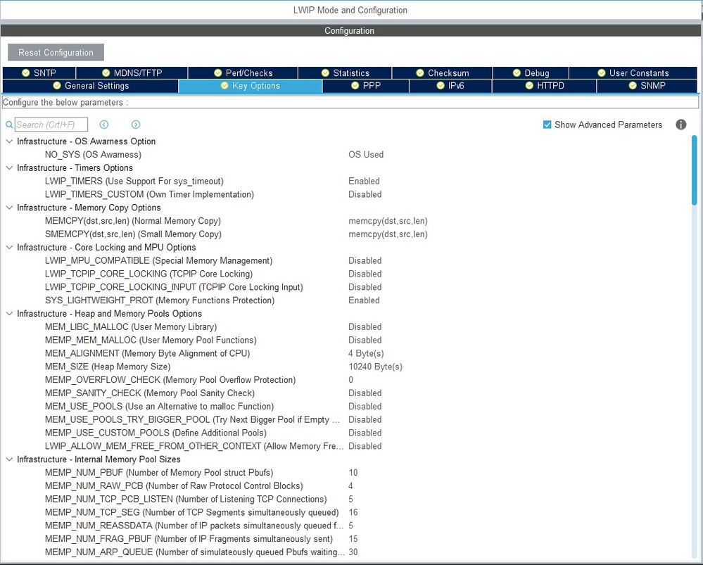

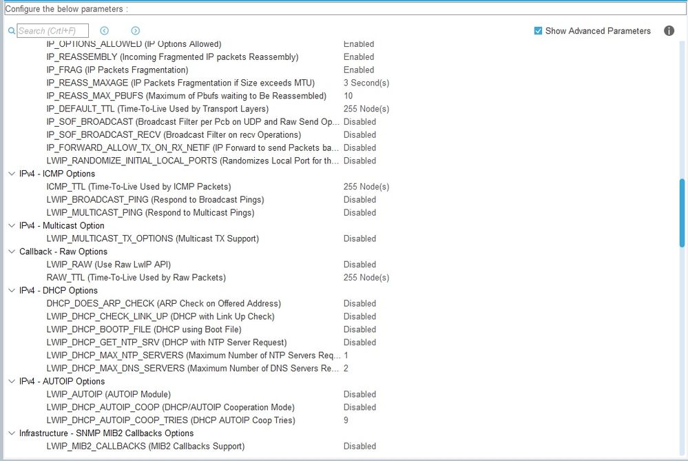

2019-12-15 1:20 PM

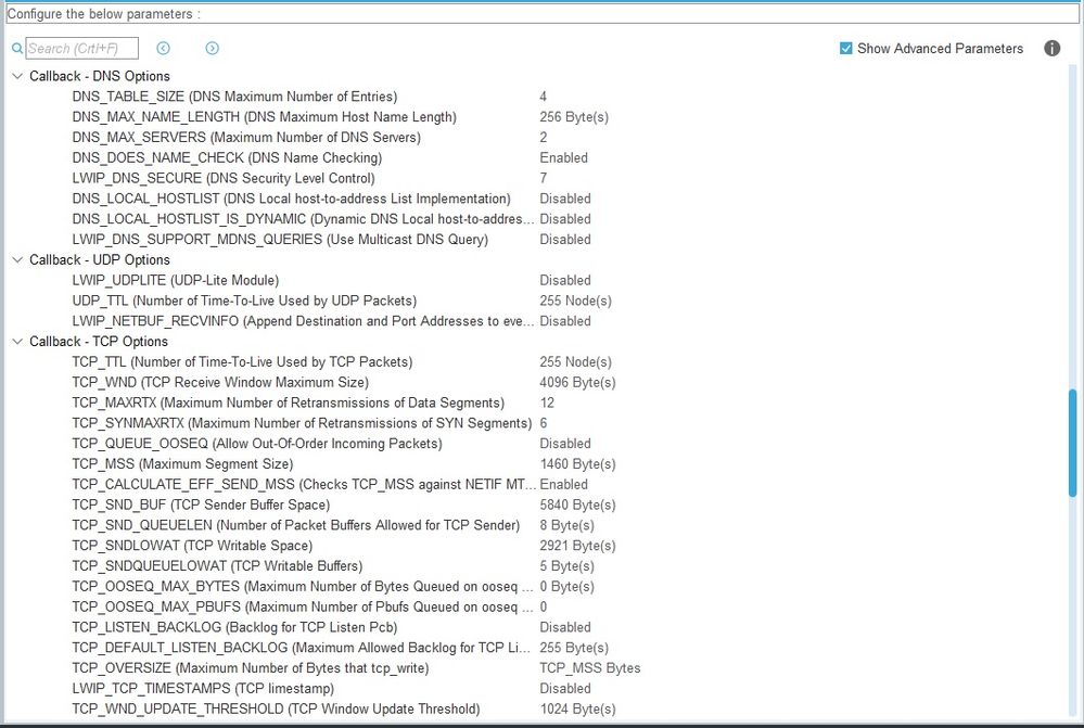

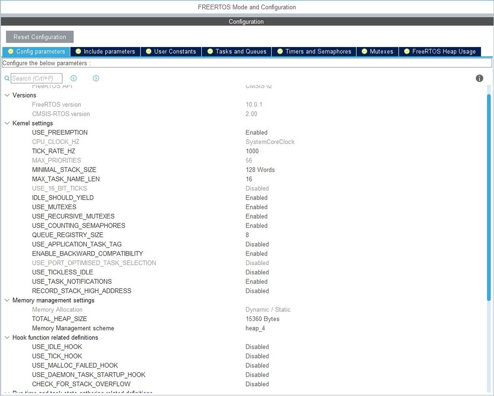

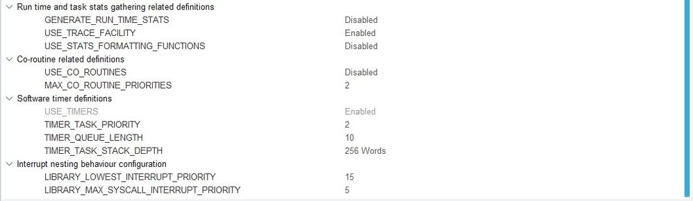

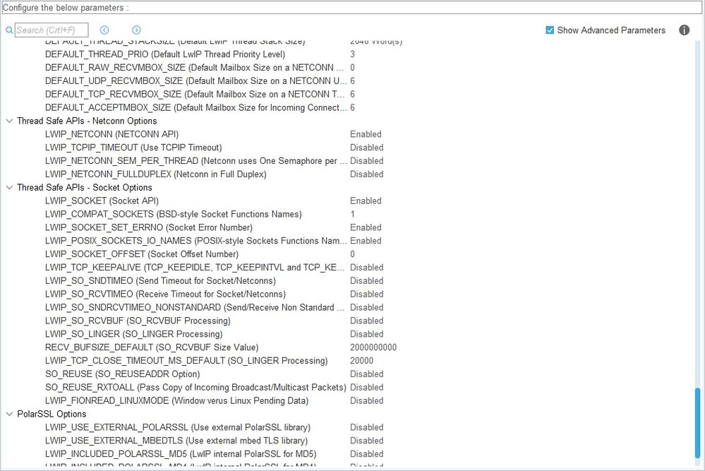

Hi everybody and @WBOUG
I tried to use LwIP_HTTP_Server_Netconn_RTOS example on STM32CubeIDE. (STM32F767ZI-NUCLEO BOARD) but it could not run properly.
it works for 2 mins then stucks. (Sometimes it effects the other tasks sometimes it doesn't)
I share all configurations' screenshots.
I would be grateful if you show me where I have the mistake.

/* MPU Configuration */
void MPU_Config(void)
MPU_Region_InitTypeDef MPU_InitStruct = {0};
/* Disables the MPU */
HAL_MPU_Disable();
/** Initializes and configures the Region and the memory to be protected
MPU_InitStruct.Enable = MPU_REGION_ENABLE;
MPU_InitStruct.Number = MPU_REGION_NUMBER0;
MPU_InitStruct.BaseAddress = 0x2007C000;
MPU_InitStruct.Size = MPU_REGION_SIZE_256B;
MPU_InitStruct.SubRegionDisable = 0x0;
MPU_InitStruct.TypeExtField = MPU_TEX_LEVEL0;
MPU_InitStruct.AccessPermission = MPU_REGION_FULL_ACCESS;
MPU_InitStruct.DisableExec = MPU_INSTRUCTION_ACCESS_ENABLE;
MPU_InitStruct.IsShareable = MPU_ACCESS_NOT_SHAREABLE;
MPU_InitStruct.IsCacheable = MPU_ACCESS_NOT_CACHEABLE;
MPU_InitStruct.IsBufferable = MPU_ACCESS_BUFFERABLE;
HAL_MPU_ConfigRegion(&MPU_InitStruct);
MPU_InitStruct.Number = MPU_REGION_NUMBER1;
MPU_InitStruct.BaseAddress = 0x20080000;
MPU_InitStruct.Size = MPU_REGION_SIZE_16KB;
MPU_InitStruct.IsCacheable = MPU_ACCESS_CACHEABLE;
MPU_InitStruct.IsBufferable = MPU_ACCESS_NOT_BUFFERABLE;
/* Enables the MPU */
HAL_MPU_Enable(MPU_PRIVILEGED_DEFAULT);
}2019-12-17 2:14 AM
