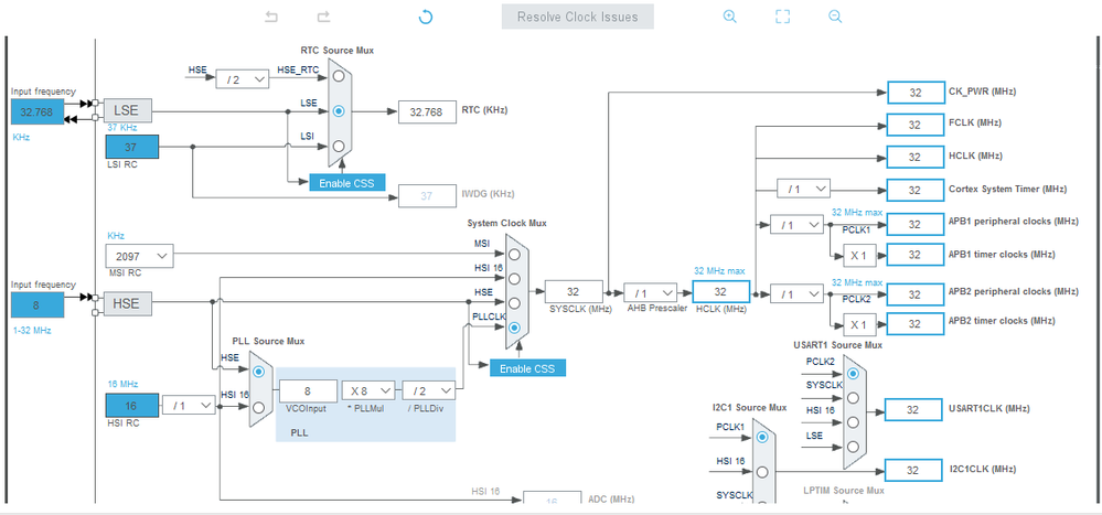

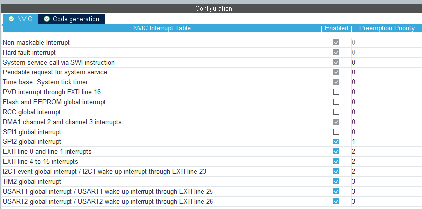

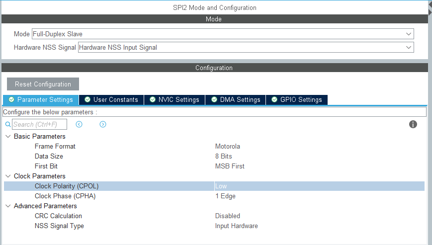

I have a random strange delay on SPI2 callback function on my SPI slave application.
Normally the function is called regular after interrupt handling without delay but casually is affected by 1ms delay before its execution!
void HAL_SPI_TxRxCpltCallback(SPI_HandleTypeDef *hspi)
if(hspi->Instance==SPI1) // SPI MASTER
ACC_ADXL_355.wTransferState = TRANSFER_COMPLETE;
ACC_ADXL_345.wTransferState = TRANSFER_COMPLETE;
ACC_MA_352.wTransferState = TRANSFER_COMPLETE;
ACC_ADIS_16209.wTransferState = TRANSFER_COMPLETE;
else if(hspi->Instance==SPI2) // SPI SLAVE
SamplingData.SPI_Slave.wTransferState = TRANSFER_COMPLETE;
}This make an error on SPI slave response and the master receive a wrong data packet.
Do you have any suggestion to avoid this condition and call this function wiyhout delay?
