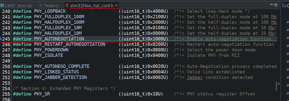

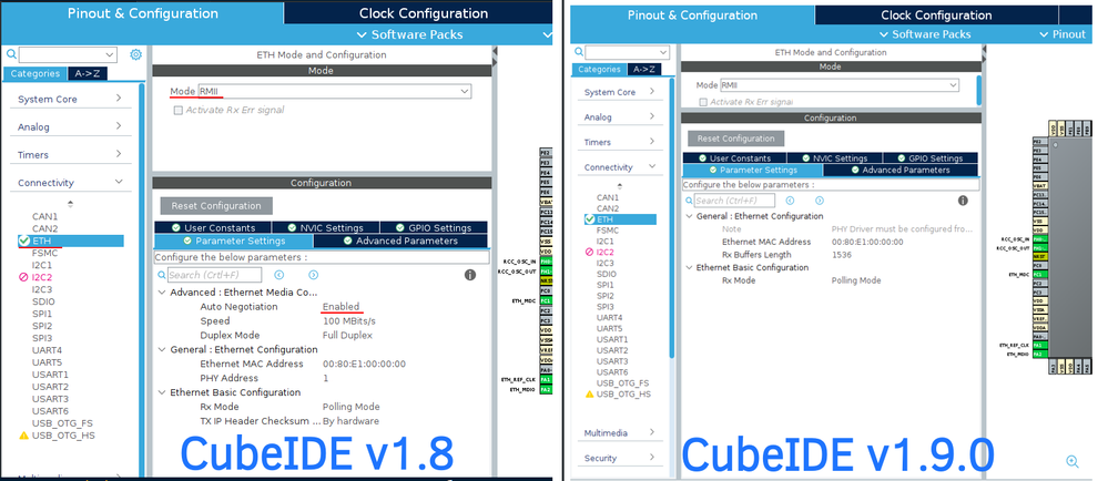

I compared what was before and what we have now, see screen...
Maybe to me need only turn on "Auto Negotiation" in main.c and ping will start working but, I don't know how to do it?

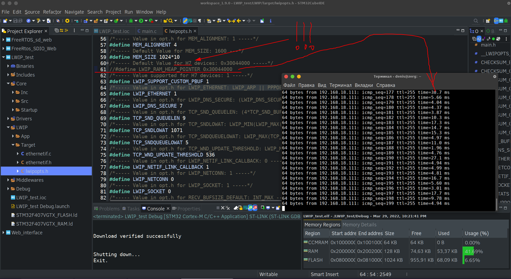

Should look at the LWIP_RAM_HEAP_POINTER definition
0x30044000 doesn't strike me as a valid RAM region in the STM32F4 devices.
Make sure it's building for the right target

No, I was wrong when I thought that to me need just activate "Auto Negotiation" it is already activated in stm32f4xx_hal_conf.h
Any ideas?

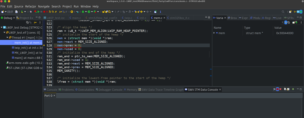

How to find out what's actually causing it?
I'm debugging it and it write to my nothing.
After the underlined line on attached screen code immediately flies into "void HardFault_Handler(void)"

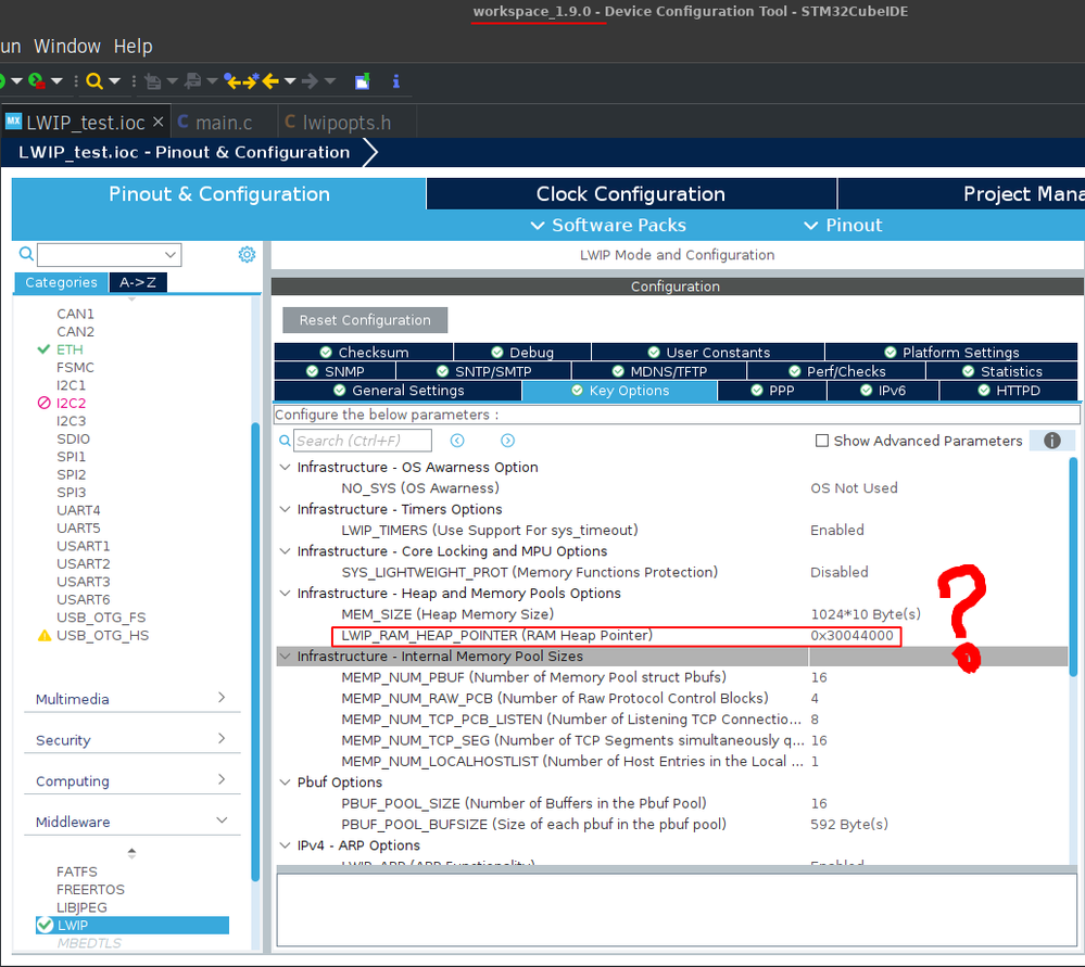

2022-03-29 12:35 PM
THANK YOU!!!!!!!!!!!!!!!!!
Everything start working after commented "LWIP_RAM_HEAP_POINTER" for stm32f407vg!
Is it possible to disable "LWIP_RAM_HEAP_POINTER" in GUI?
