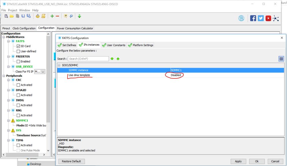

Hi, so i found out, that in order to use Blocked non DMA SDIO communication, there is a dropdown menue hidden in CubeMx
There its possible to deactivate the DMA template, which is always on as standard. Deactivate it an USB & FAT works fine without any tweaks.
2018-02-11 5:39 AM
Nice! They really hide this one well
