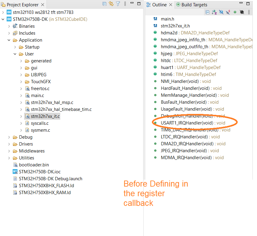

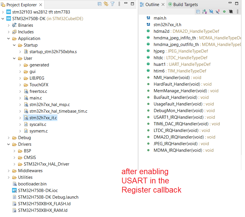

Thank you @Pavel A. , please note the below sceenshots
Please note I couldn't locate the file stm32h7xx_hal_conf.h in the project tree. Please advise.

After enabling the callback you still have the USART1_IRQHandler.
The stm32h7xx_hal_conf.h should be in Core/Inc (or maybe generated/Inc for emWin projects). Use dir /s command to find.
