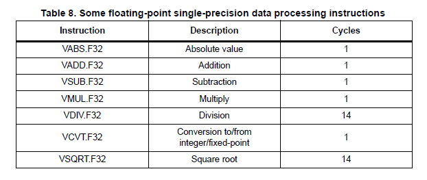

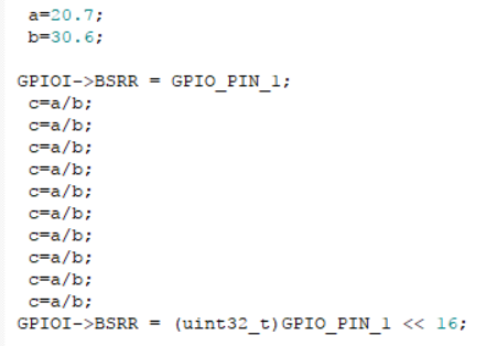

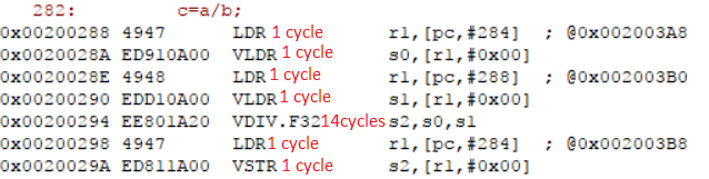

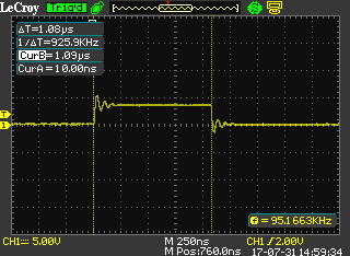

Instead of measuring the NOP, I preferred to measure the execution time of a math operation: in this case the division.I found the AN4044 ''Floating Point Unit demonstration on STM32 microcontrollers'' where is reported the number of machine cycle associated to each math operation:The time for 10 division operation is 1.08us, so dividing this interval by 10, the time for a single division is 108ns.
Dividing 108ns by 20 (14 cycles+6 cycles) I have the time of one cycle that is 5.4ns.2017-07-31 11:21 AM

Stop using C, and replicate the VDIV.F32 s2,s0,s1 10x or 100x times in assembler. This will show the execution of the instruction, not the pairing or pipeline stalls other sequences might introduce.
Is 14 cycles the maximum? Could certain data foreshorten this?
Multiplication by a reciprocal could get you to 1 cycle for this division.
A compiler paying attention could fold this code.
