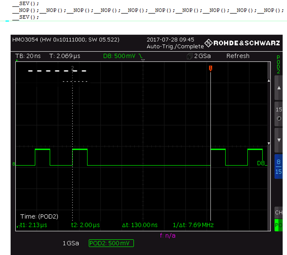

Try using SEV instruction to emit a pulse instead of toggling GPIOs.
Wrapping 10 NOPs with SEVs on a STM32F401 clocked at 84MHz is consistent with what expected
