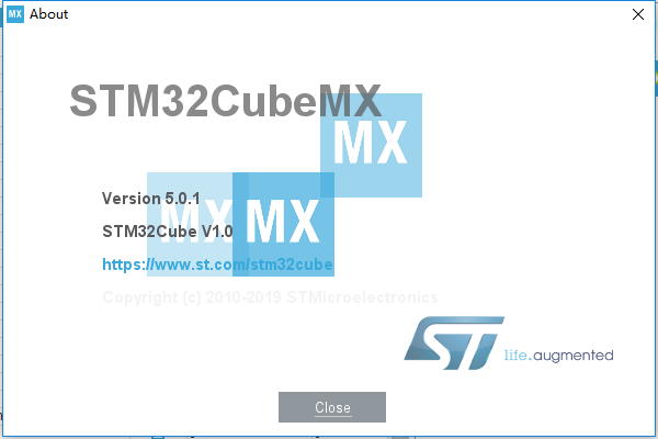

Which CubeMx and Cube package versions used ?

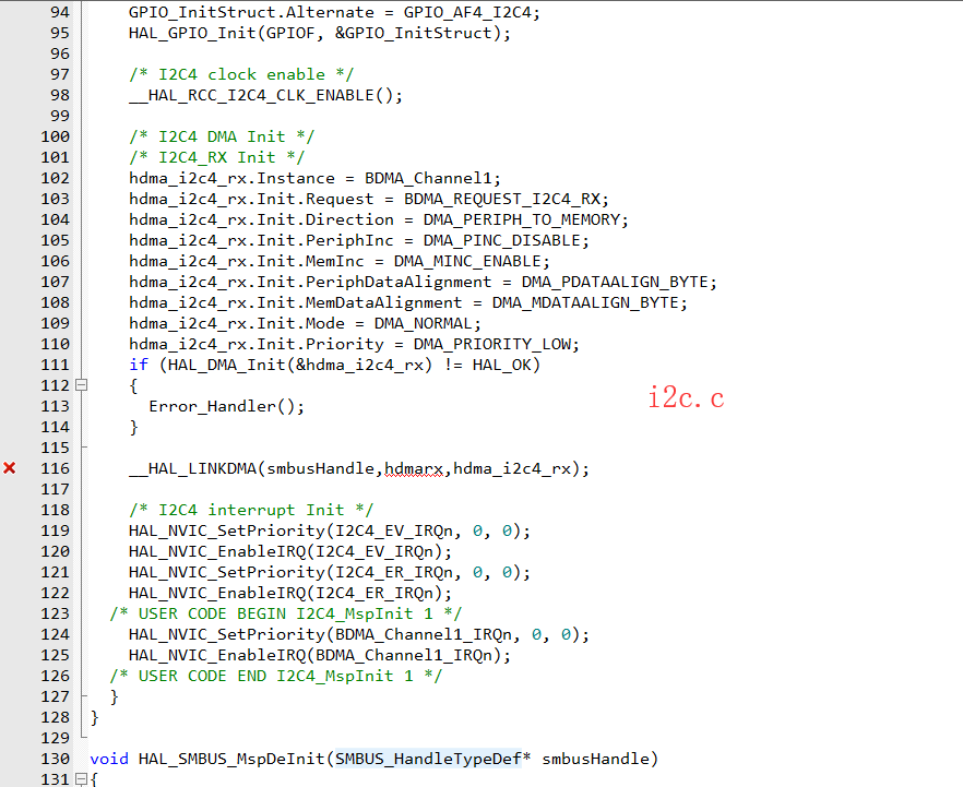

After more check, I confirm that the problem exists for hdmarx and hdmatx with I2C4.

By the way, i2c4 can read external device data, but the i2c+BMDA method does not work. How to solve it?

So, the code generated by STM32CUBEMX(5.0.1) in I2C4+BDMA mode is not working now?

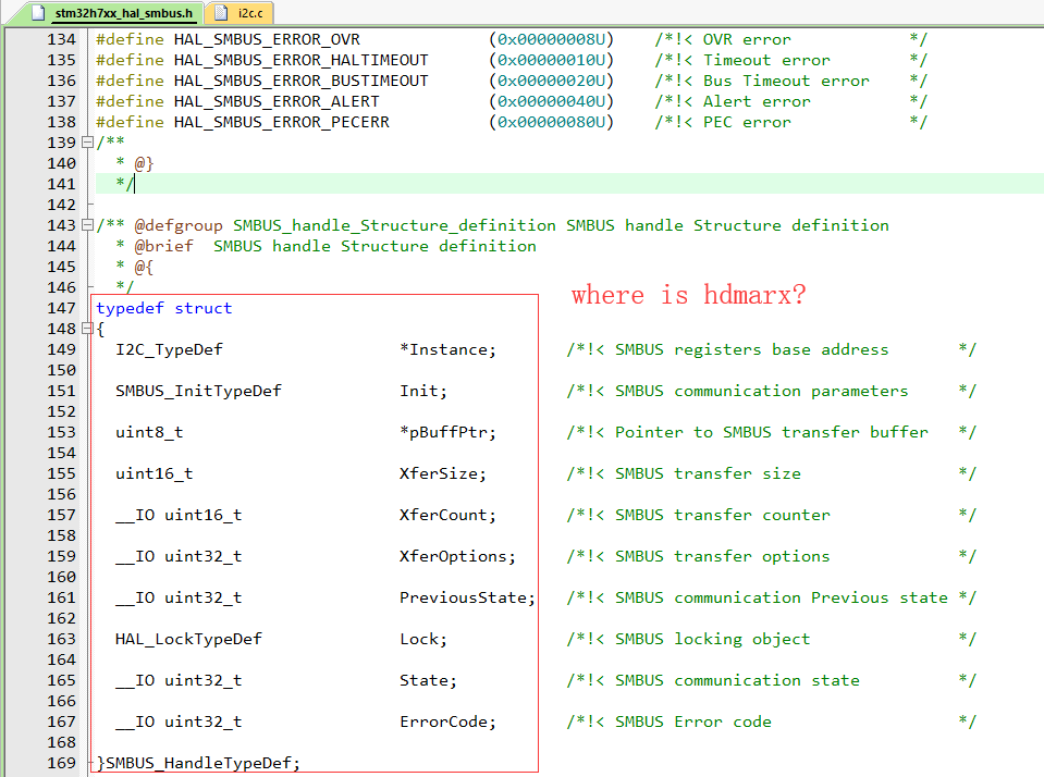

Hi @one V

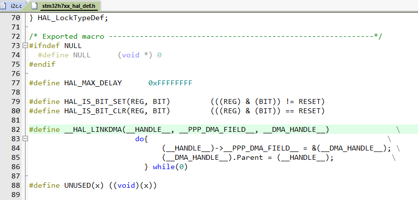

In STM32Cube_FW_H7_V1.3.2\Drivers\STM32H7xx_HAL_Driver\Inc path.
In the typedef struct __I2C_HandleTypeDef of stm32h7xx_hal_i2c.h file, you will find :
DMA_HandleTypeDef *hdmatx;
DMA_HandleTypeDef *hdmarx;
but it isn't available in stm32h7xx_hal_smbus.h

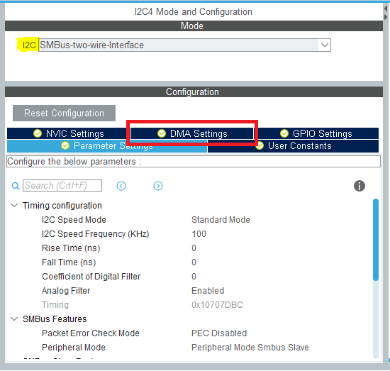

So, when I2C mode is set to one of the SMBUS modes as shown in this figure:
The DMA Tab must be removed when I2C is set to SMBUS mode .
==> This problem only exists for I2C4.
This bug will be fixed in the next STM32CubeMX version ( STM32CubeMX 5.1: That will be available Week 9 ).
