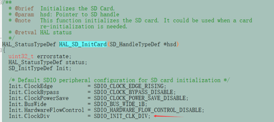

I think the problem here is that this macro definition is used in the HAL_SD_InitCard function called by HAL_SD_Init.
The main purpose of HAL_SD_InitCard is to generate a series of commands for SD card initialization. This value cannot be changed by the user through the parameter, which will cause the clock to exceed the specified 400KHz.
Using the generated code directly will result in an inappropriate clock rate at initialization time.

I guess the issue is linked to the definition of SDMMC_INIT_CLK_DIV. Could you try to update the value accordingly and make sure not exceeding 48MHz. This issue is not present in new products since we have dynamic solution.
#define SDIO_INIT_CLK_DIV ((uint8_t)0x79) /* 48MHz / (SDMMC_INIT_CLK_DIV + 2) < 400KHz */
