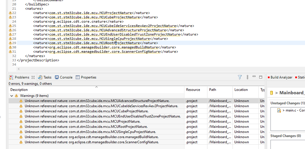

the only picture that I can send right now is the one showing that my .ioc file was made in a CubeMX version newer that the one currently installed so until I can update the Cube IDe I can't easily modify the configuration of my project.
here is the picture
may be with the version of the STM32CubeMX you can track the update that is related to the problem but right now I don't have screenshots of the problem.
2020-12-18 1:16 AM
I have the same Problem. After installing the 1.5.1 update, this problem occurs and it's not possible to Build a project anymore.

2020-12-18 1:48 AM
Hi, windows 10 Pro 64 bits, and it's what @Johnny says, the problem is with the IDE update version 1.5.1 and the screenshots attached by him shows the same notifications that I saw
