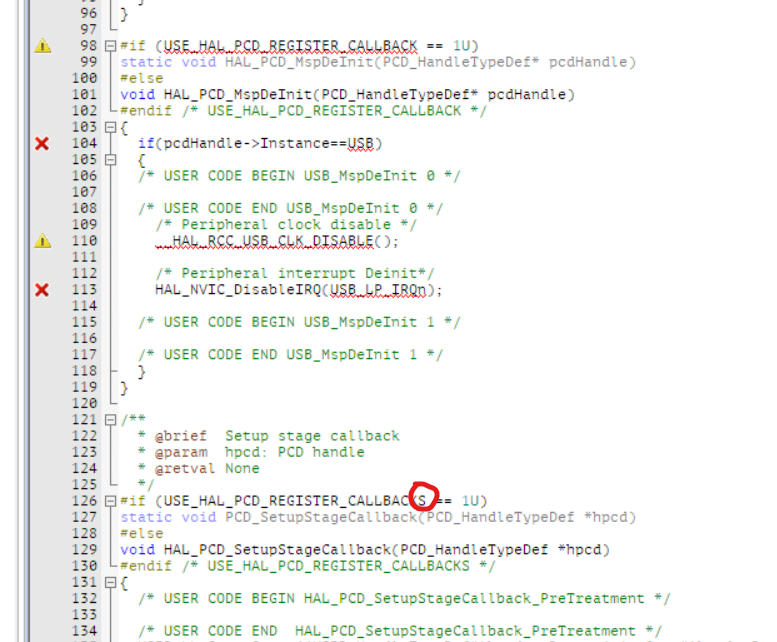

Output in the usbd_conf.c file when generating code for a CDC device. Code is using USE_HAL_PCD_REGISTER_CALLBACK for HAL_PCD_MspInit and HAL_PCD_MspDeInit instead of USE_HAL_PCD_REGISTER_CALLBACKS (note the final 'S'), which was there in previous versions of the tool.

Hi @pbk ,
Which STM32 product please?
I need to check if root cause is the template files provided in the STM32Cube firmware package or not.
-Amel

Hi.
Sorry for the late reply. I was getting site errors while trying to log during the last days. Today it worked.
This is for the STM32G4 pack.
Best regards.
2021-08-31 4:51 AM
Thanks @pbk for sharing these details.
Our STM32CubeMX expert @Khouloud OTHMAN will take care to confirm & track the issue.
-Amel
2021-09-02 7:12 AM
Hi @pbk,
Good catch! I raised your feedback internally to be reviewed. I'll surely keep you posted with the updates.
Thanks for you contribution.
Internal ticket number: 112736 (PS: This is an internal tracking number and is not accessible or usable by customers).
Khouloud.
