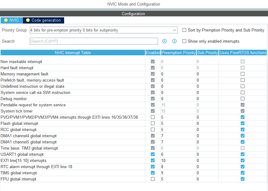

2019-04-10 8:38 PM
I have seen the Cube's NVIC Settings. Settings for RTC and for other interruprts are same. You can see they at this screenshot.
2019-04-11 1:45 AM
I have found a bug...
The priority of RTC was set from two places =)
One place was in Cube's code, about that I have told earlier. It set priority to value 8.
Second place was in my one code about that I have fogotten at all =) And second place set priority to 0! =)
When we came to configASSERT the 57th element in array had been set to 0 already =)
When I have killed the second priority setting everything works fine.
