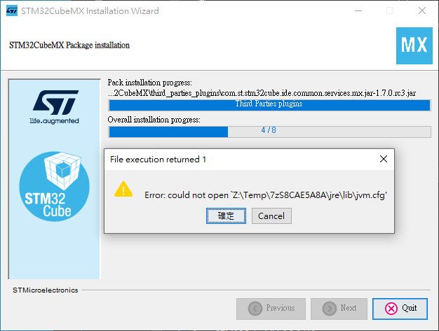

Used this from STM website: en.stm32cubemx-win_v6-3-0_v6.3.0
There is not much to say about. Installation runs for a while then stops with that error (cannot open jvm.cfg (it is nowhere)).
Tried a couple of times, also after having removed everything with an uninstaller from the failed installations (including registry setting).

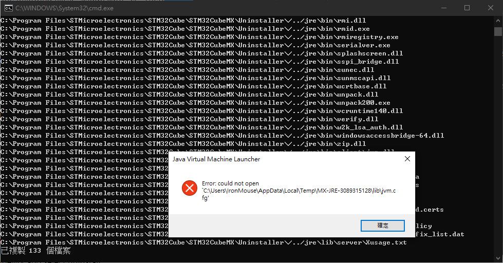

Hi @Khouloud ZEMMELI ,
I have same problem.
Error message is from install process 4, and in uninstall.
The folder is existed, just jvm.cfg is missing.
How to fix it?
Thanks.

Hi @Ggast ,
After some try-and-error, it work for me.
Because some jre files is not extracted from installer.
Try to extract "SetupSTM32CubeMX-6.3.0-Win.exe" manually(ex. WinRAR).
You will get "jre" folder, "Readme.html" and "SetupSTM32CubeMX-6.3.0.exe".
Run "SetupSTM32CubeMX-6.3.0.exe" with administrators rights.
Thanks.
