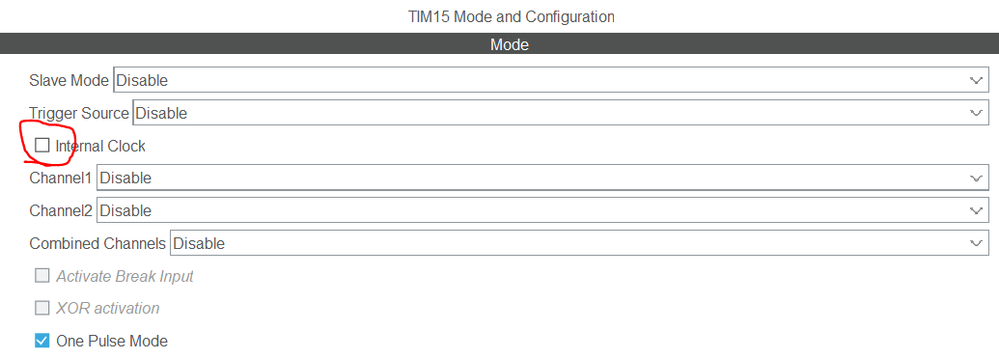

What "seemed" to fix this issue is I tried unchecking the radio box to use the internal clock as the source for the other one-shot timer that I have been fighting (TIM15). I assumed that every timer needs some sort of timer to sync with and since this was the only option I assumed it needed to be checked. I guess I'm wrong. I unchecked it and not only did everything start working again, but the TIM15 was still operating as a slave to the 120MHz main internal system clock. I know this because my ARR period settings were still set up for 120MHz source and the timing at the output of TIM15 still worked the same.
So let me ask, what does checking this box do if the timer is going to sync to the internal clock regardless?
Checking this box seems to do nothing but break the timer set up as the timebase for FreeRTOS.

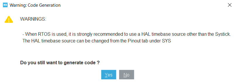

Why your FreeRTOS timer is TIM3 instead of systick?
It should be the other way, al least in the ST-maintained version.
Make TIM3 the HAL timer, leave systick to FreeRTOS. You can even make the HAL timer tickless (free running without interrupts) and rewrite HAL_GetTick etc,

MxCube selected TIM3 by default and since the max frequency the FreeRTOS kernel tick can be configured as is 1ms, I haven't seen a reason to change it. I'll give it a try, but I have heard from other sources that doing this is a bad idea because it restricts what freeRTOS functions can be called and caused other issues. Again, I'll give it a try and let you know how it goes.
2022-03-14 4:46 PM
On second thought, I'm not even going to try it.
