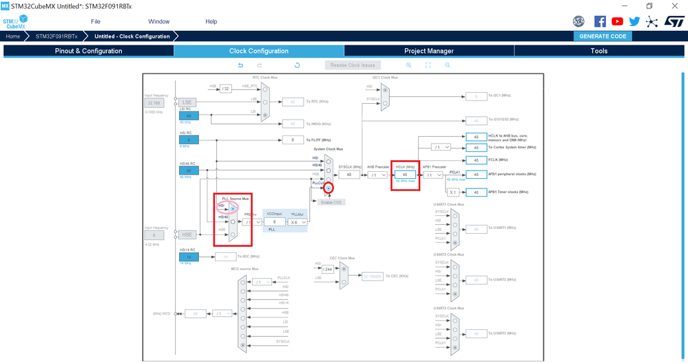

Hi @Mgawa.1 ,
You can use STM32CubeMx software which is freely downloadable from ST official website.
Here is the code generated by CubeMX:

2021-05-28 1:44 AM
Hi @Mgawa.1 ,
I meant you can use Mx for generating the Clock config only, and replace the generated code by Mx in your project.
This is how I did it:
This is really a simple and clean way to have a "correct" clock config that fits your preferences.
