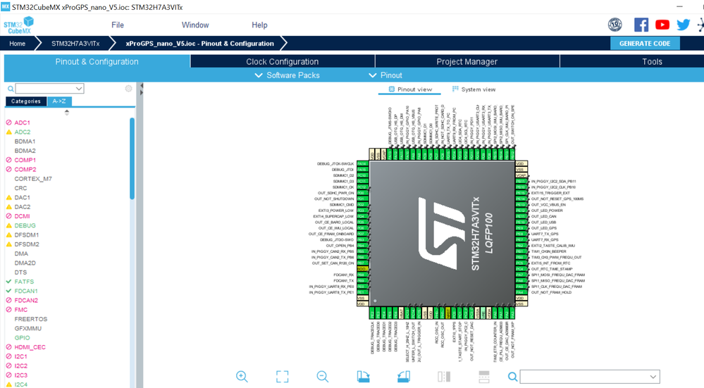

When trying to import a working project (STM32H7A3VITx processor) the import function is locking up and does not finish.
Please see attached file which can not be imported.
BR GS

Actually you're right, I can confirm that trying to import your attached project "xProGPS_nano_V5.ioc", STM32CubeMX will take an eternity to import it to a new MCU.
This behavior is somewhat related to the project you're trying to import because as far as I can see many peripherals are configured and almost all the pins are assigned:
Not being able to import this project doesn't mean that the Import project feature of STM32CubeMX is unfunctional since other project with simpler configuration can be imported successfully. But, it will be better to add a warning message or display a tooltip to warn users of this behavior.

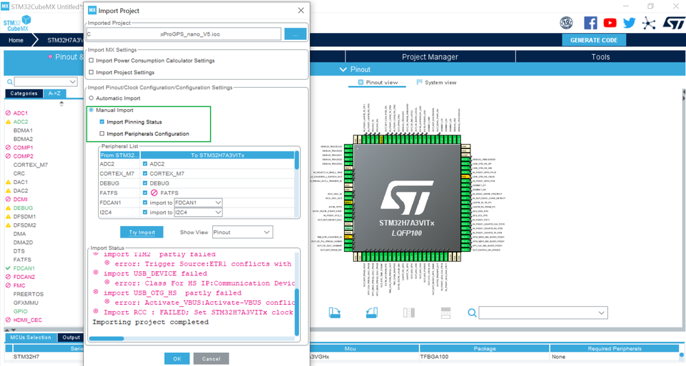

Otherwise, you can attempt to import a subset of your xProGPS_nano_V5 project by using Manual Import. in this case, checkboxes allow you to manually select the set of peripherals.
From my side, I have tried to uncheck "Import Peripherals Configuration" and in this case the project has been imported:

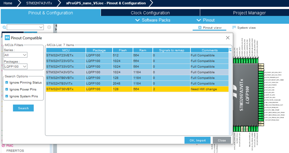

Furthermore, you can use List Pinout Compatible MCUs feature:
To explain briefly its functionalities, for a non-empty project, the Pinout Compatible ensures that Modes and Signals mapped on Pins in the project are also mappable on the equivalent Pins in the targeted MCU. Clicking “OK, Import�? button, it will assure the import of the same pin configuration (same signals assignment and not IPs configuration).
For more details you can refer to the STM32CubeMX User Manual.
