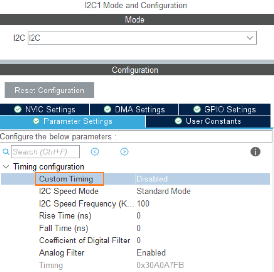

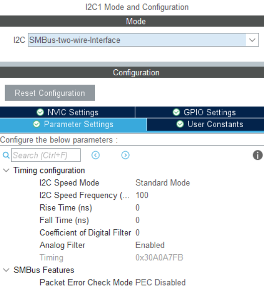

Why CubeMX I2C Custom Timing MCU connectivity config option is unavailable in SMBus mode? Custom Timing is an advanced option for those which really know what they are doing and I do not think it makes sense to take it away in SMBus mode.

In the other hand The SMBus (System Management Bus) mode is a variant of the I2C protocol that includes additional features such as support for alert responses and block transactions. When the I2C peripheral is configured to operate in SMBus mode, it uses fixed timing parameters that are specified in the SMBus specification. As a result, the option to set custom timing for the I2C communication may not be available when the SMBus mode is selected.

@Ghofrane GSOURI​ Thank you for your response.
I am well aware of SMBus standard being more strict than I2C although: 1) the same timings can be achieved in more than one way, e.g. depending on PRESC registry value. 2) Custom Timings are for those who really know what they are doing and, I believe, there is no need for CubeMX to protect such engineers from making mistakes. 3) I believe that CubeMX does not always calculate correct settings, which I explained in a different post some time ago, that includes SMBus mode. For that reason, I always prefer calculating timings and registry settings myself, including SMBus. That is the reality.
