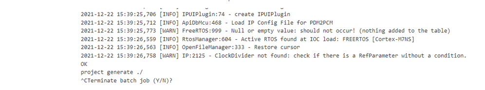

Olivier,
Below is the batch file I am invoking from Jenkins to automate the CubeMX build. Following that is the CubeMX script file. When I run the batch file from the command file it works fine. Although I do get a progress bar during the "project generate" phase. Because I use the -q qualifier, I would not expect this progress bar. But when running from Jenkins I get the following:
Everything seems to be working fine until "project generate". I terminate after a few minutes. Could it be that CubeMX is trying to display the progress bar?

2022-01-05 10:39 AM
Olivier,
