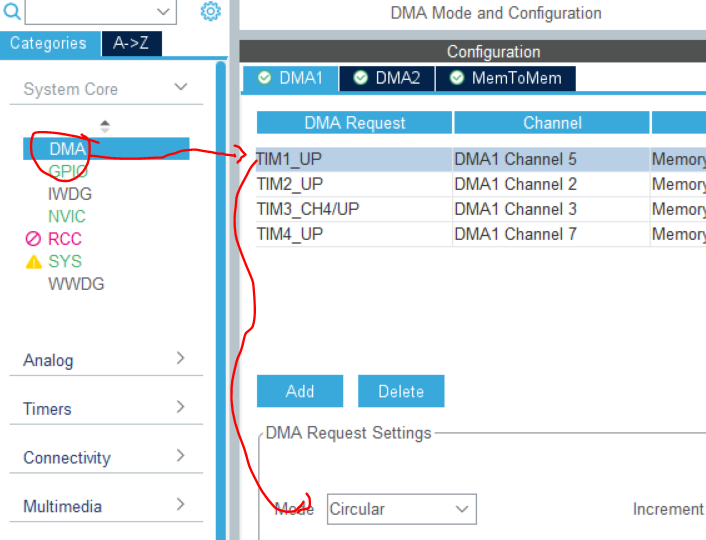

2021-10-08 3:26 AM
are you using CUBEMX?
2021-10-08 4:37 AM
yes , i can use it, just to create and understand the strcuture
2021-10-08 4:54 AM
well, good news, CUBEMX has an option for you :D
2021-10-08 6:56 AM
thx , i will try this evening
