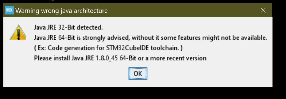

2020-04-27 9:11 PM
HI TDK,
Thanks for the advice,
This is the warning I got when I open the CubeMx:

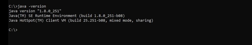

This is the Java version install on my laptop. When open the "cmd" to run the command: java -version.
As you can see I have the latest version of Java, which is a 64-bit. I don't see how the CubeMx software detect a 32-bit,

2020-04-29 3:56 PM
I don't think that is 64-bit.
My install says this:
Java(TM) SE Runtime Environment (build 1.8.0_251-b08)
Java HotSpot(TM) 64-Bit Server VM (build 25.251-b08, mixed mode)
2020-04-29 9:13 PM
Thanks! I see the problem.
I had to uninstall the Java 8.0_251-b08
and download a Java: jre-8U251-window-x64.exe from
https://java.com/en/download/manual.jsp
to resolve my warring message.
My assumption was the latest Java version 8 update 251 was the latest and I read somewhere on the website it was a 64-bit. I was wrong.
Thanks for all the help and point me to the right direction.
