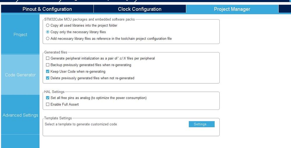

You should add the functions in the User Code section:
/* USER CODE BEGIN 0 */
/* USER CODE END 0 */Ensure that following option is checked : "Keep User Code when re-generating". In this case, the user sections defined by STM32CubeMX are preserved.

Hello @NSemrHomeInit ,
You should set the Backup previously generated files when re-generating option :
Hope this helps you.

2020-10-16 8:32 AM
