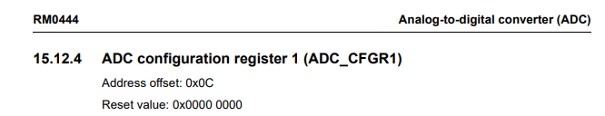

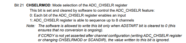

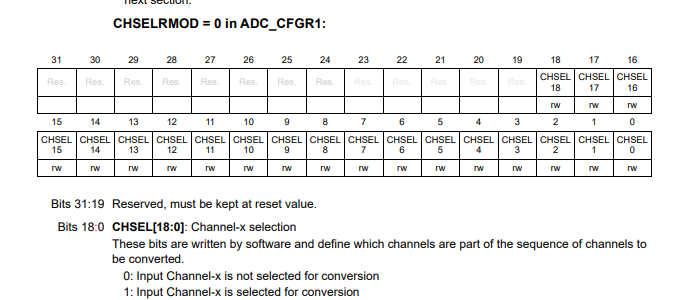

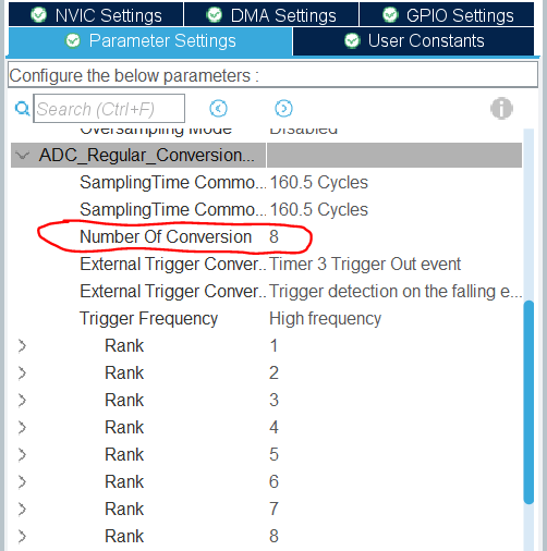

from
set
but you want > 8 ch , so :
ok ?
