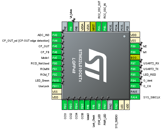

Here is the configuration:
I using ADC channels 1, 3, 6 and Vrefint.

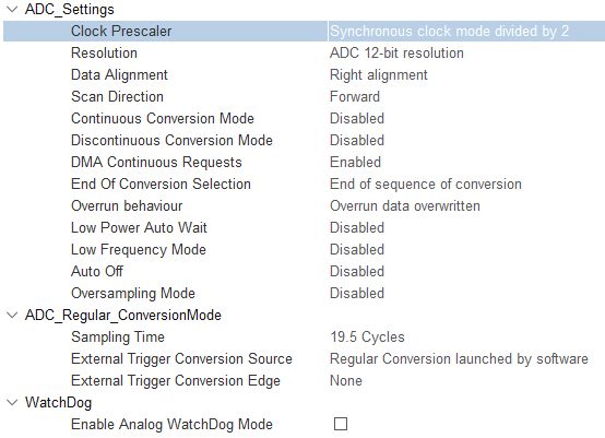

Here is the ADC configuration:

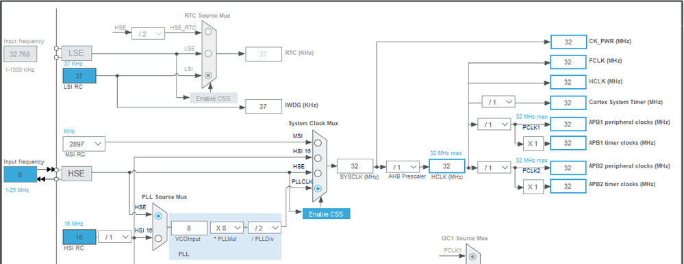

I forgot the clock configuration:

You did not tell us the ADC clock frequency/APB frequency, but I bet 19.5 cycles sampling time violates the min 5us typ. (read recommended ) 10us ADC sampling time when reading the internal reference voltage value given in the datasheet.
