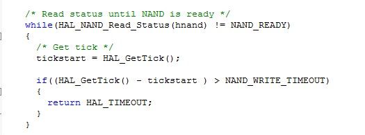

When I meet a bad block in a NAND flash,it will stop here forever.
The 'tickstart = HAL_GetTick()' should put in front of 'while(HAL_NAND_Read_Status(hnand) != NAND_READY)'.

Hi
mai.jiehong
,I confirm this error which I tracked internally. Thanks for reporting it.
